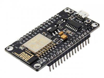

When ESP8266 (NODEMCU) meets Thingspeak we can found real time data. Yeah it is true. In this project we have interfaced NODMCU with dht11 sensor as well as sending temperature and humidity data to Thingspeak server.
Step 1: Supplies:
Hardware and software requirements:
1.NodeMCU
2.DHT11 sensor
3.Jumper wires
4.Breadboard (optional)
5.USB cable
6.An active Thingspeak account

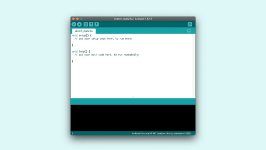

Step 2: Installation of Arduino IDE
Now first of all we need to download and install the Arduino IDE as we have shown in above figure.
You can refer Download Arduino IDE for downloading and installing the Arduino IDE.
Step 3: Now It’s Time to Congfigure NodeMCU in Arduino IDE
This are the steps:
Step1: After installing the Arduino IDE we need to open it.
Step2: Now you need to click on a file. Then you have to click on preferences.
Step3: Now you will get one window like above figure. Now you need to copy this URL in the Additional board manager. This is the URL http://arduino.esp8266.com/stable/package_esp8266com_index.json you can copy it and paste it on your Additional board manager.
Step4: Now come back to the home screen (Arduino IDE) and click on Tools then select the Board manager then select ESP8266 Boards and then scroll down on that window you will get NodeMCU 1.0(ESP-12E Module) as shown in above figure.
Step5: Now restart your Arduino IDE.
