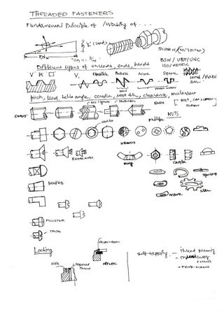

A screw is really a shaft with a helical groove or thread formed on its surface. Its main uses are as a threaded fastener used to hold objects together, and as a simple machine used to translate torque into linear force. It can also be defined as an inclined plane wrapped around a shaft.
Every threaded fastener needs a way of turning it. Whether a wrench fits a hex-head bolt or a nut, or it may have a shaped and recessed hole into which a driver can be inserted.
