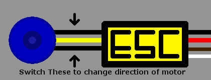

For a Quadcopter your going to need four motors, two turning Clock Wise (CW) and two turning Counter Clock Wise (CCW). Now all motors are able to turn both CW and CCW, but the difference is in the threads on the Prop Huns on the motor. You want it to turn so that the Props Tighten when the motors are spinning. On each motor there are three wires, To change the direction of rotation just switch the two outside wires around. Regarding the power that your motors are going to output, you want to have 4 times more power then needed so you can maneuver easily.

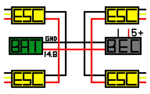

Power Distribution System
You only need one system to distribute power to all the ESCs. There are two main options, a Power Distribution Board (PDB) and a wire harness with possible UBEC. PDBs are boards that have solder pads for all the ESCs and your Battery to connect to and normally have a built in BEC to power your flight Controller. The other option is buying or making a wire harness that allows all 4 ESCs to connect to the battery, and you can either power your Flight Controller from the ESCs built in BEC or you can buy a separate UBEC to power it.
My plans are to use 12awg wire to build a wire harness and I'm debating whether to get a 5v UBEC to power my Flight Controller and Receiver, you can see the idea in the images. I would recommend some kind of connectors like bullet connectors so you can easily dissemble everything easily.

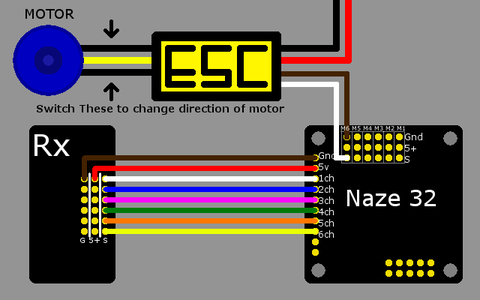

The Control System is the brains of the operations that allows you to control it while also providing computer help to keep it in the Air.
Flight Controller
You will need a Flight Controller so that your drone can self level and stay in the air, that is not all it does but that is the main purpose of it. There are many Flight Controllers to choose from like KK2.1.5, Naze32, and ArduPilot, are some off the top of my head. Sadly there is not one answer to this, but I found that the Naze32 has all the ability's I need and is not hard to set up. The KK2.1.5 is also a popular board because of its ease of setup.
I'm getting a Naze32 Flight Controller with a barometer and magnetometer.
Receiver/Transmitter
Your going to need a Receiver for each drone you make, so if you are going to have more then one Drone then I would search for a Transmitter that can save multiple setups. The amount of Channels depends on what else you want to add onto your drone, but for a beginner I would recommend a 6Ch Transmitter/Receiver bundle unless you know you need more channels.
I'm going to buy a FlySky fs-i6 controller, it has good range, a good price, and I have seen a 10Ch upgrade you can do to it.
