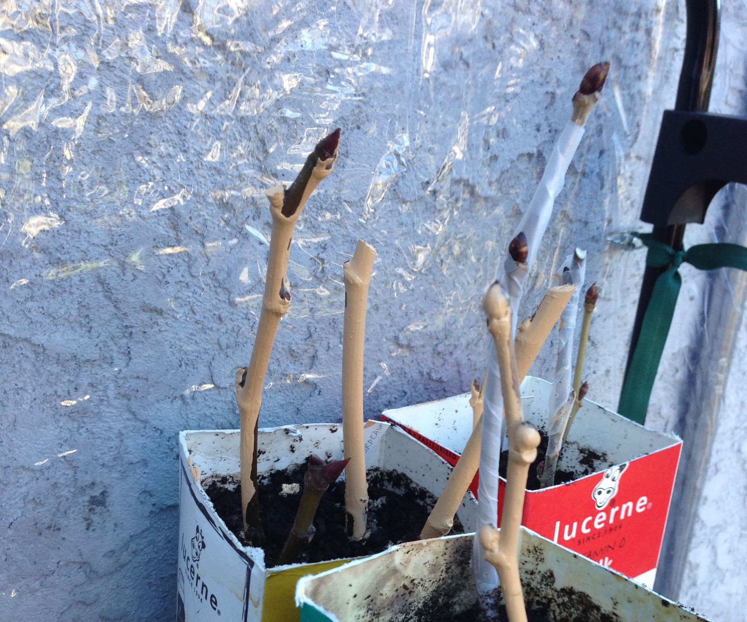

Step 1: Collecting Scions
In January I collect the varieties I want to graft on to my fruit trees. I cut the branches to fit a plastic sealable bag, and put a damp piece of napkin in the bag to keep them from drying out. I label each bag with the name of the variety and type of fruit, and place the bag in the fridge (not the freezer).
If the scion dries out before the graft is established, the branch will die, so we need to do our best to keep the branch from drying out. Before the scion is grafted, we keep it "wet" by placing a damp napkin in the bag, and, after the scion is grafted, we keep it from drying out by covering it with latex paint or grafting tape.
The images are from the 2014 CRFG-SCV (California Rare Fruit Growers, Santa Clara Valley Chapter) Scion Exchange. Hundreds to thousands of varieties of scions are available at such exchanges!
