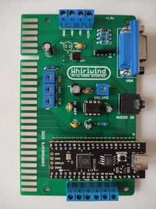

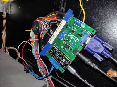

The present Instructables deals with the development of the last (but not least eventually?) Jammarduino iteration: Whirlwind. Based on Raspberry Pi Pico, it makes all the previous versions obsolete.

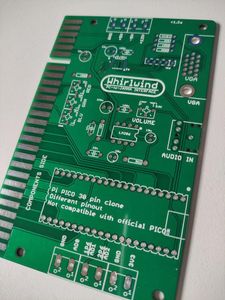

About the microcontroller board: you are in the need for one of those Pi Pico clones with alternate pinout (see attached picture). These alternate pinout boards are commonly in purprle color, but you can also see them in black. The same is true for standard pinout boards: often seen in green, but also in black. The message is: do not trust the Pico PCB coloration.
Again: a standard pinout Raspberry Pi Pico will not work here! It has a different and non compatible pinout with the Pi Pico this project is built around.

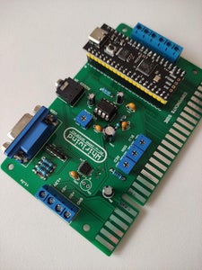

Raspberry Pi Pico (30 pin variant clone) is the brain of the project and in charge of a whole lot of tasks:
(a) it monitors the video sync frequency
(b) keeps track user inputs (button presses, potentiometers positions, etc.)
(c) emulates the Human Interface Device (HID) of choice.
The microcontroller translates control panel buttons, coin switch and service switches actuations into keyboard key presses or joystick buttons presses (or whatever you want them to do!).
Pi Pico is powered by the USB port it is connected to and there's not the need for an additional power supply.
Incoming RGB signals from the PC video card VGA connector are directed to the video amplifier circuit (THS7374). On the video amp output stage a set of tree trimpots helps adjusting the R, G or B signal to fine tune the image colors.
Please notice that the 2X gain the THS7374 provides could be not sufficient to gain a decent RGB amplification in some arcade monitors (i.e. Nanao). In such case a THS7375 (5X gain) could be a better choice. The sync signal passing the amplifier should not exceed 5V (the peak output tension for such IC's), but it's worth a check (you do not want to fry the monitor ASIC). Untested!
Depending on the type of CRT monitor you are using (arcade or a replacement TV) the "right" impedence differs from 75 ohms in CRT TVs to some hundreds of ohms in arcade monitors (200 being the optimum for my Hantarex, in example). Those trimpots also help in facing cathod-to-cathod differences due to ageing.
The video amplifier adopted has a very handy feature: a disable pin. This allows it's direct control from the microcontroller monitoring the sync frequency. The amplifier can be powered @ 3.3V or 5V. Powering at 5V allows for a wider range of input voltages/signals and being that THS7374 can be controlled by 3.3V signals even if juiced at 5V, you name the obvious choice.
The video amplifier circuit is powered by the USB port the Pico is connected to and don't ask for an additional power source.
JAMMA standard calls for composite sync, while VGA delivers a separate sync signal. A very simple sync circuit made of a resistor and a diode convert separate sync to composite sync .
A voltage divider lowen the 5V composite sync signal to 3.3V logic (RP2040 is not 5V tolerant!).
Three analog inputs are directly accessible via screw terminals. They can be used to interface positional guns, 270° wheels, analog pedals or any other arcade control based on potentiometers.
The built-in audio amplifier circuit is built around an LM386N and the volume can be regulated with a 10K onboard trimmer. You can eventually install a 10K ohm potentiometer instead of the trimmer, and place it in a more accessible position, if you prefer.
Please notice that this amplifier is ok to drive a classic 3 W, 8 ohms speaker, but will fry if you try to amp a lower impedance (i.e. 4 ohms) or higher power (i.e. 5 W) speaker.
Please notice that LM386 are NOT all the same! Buy only amps from thrusted manufacturer or it will likely not work properly (learned the hard way here...).
The audio amp circuit is juiced by the +12V coming from the cabinet power supply on the jamma connector. In case your cabinet is not equipped with a power supply, you can use an external power supply through the dedicated +12V screw terminal. In example, you could use one of the PC's unused power connectors and get the +12V directly from there.
Do not apply external +12V through the screw terminal if you already have +12V coming from the JAMMA harness!!
My prototipe makes +5V and -5V available for external use, in case a power supply is wired to the JAMMA harness. This has almost no real applications and makes the board more prone to failure due to wiring errors than other. This is why I have removed all those screw terminals on the upper side of the board, exept for the +12V necessary for the audio amplification.
In the shared version of the board I also added a safe diode from +12V to ground to protect from inverse polarization.

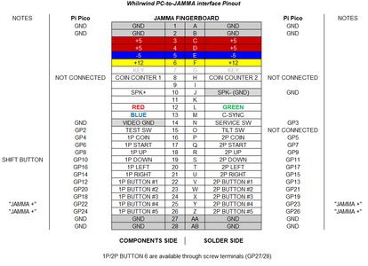

All RP2040 microcontroller board GPIOs are hardwired to JAMMA connector as per the attached pinout scheme.
Which GPIOs goes to which JAMMA pad on the connector was selected depending mainly on the phisical location of the pin on the board vs JAMMA fingerboard. The main goal was the reduction, as much as possible, of the PCB vias number.
The pinout is also described in the (verbose) base sketch I wrote (see next step). It must be obviously respected if you want to write a custom sketch compatible with Whirlwind PCB.
Please notice that the microcontroller I am using in this project also has three analog inputs (GP27, GP28 and GP29). These could be used to interface a potentiometer-based racing wheel (also known as 270° wheel), analog pedals or any other analog input a cabinet could ask for.
The three analog inputs are made available through three screw terminals in the bottom of the board. The sketch I wrote do not use them (better: use two of them as digital inputs for players button 6), but it's a matter of simple code modification to make this same interface handle such analog arcade controls.

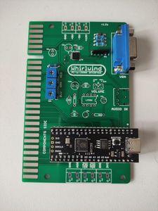

My suggestion is to solder the video amplifier IC first. You don't want to fully assemble the PCB and then realize the amplifier needs to be reworked or desoldered.
The minimum amount of components needed for a first board test is pictured. As you can see, the whole audio amplification circuit is left out in this stage. The same is true for edge connectors and filter capacitors.

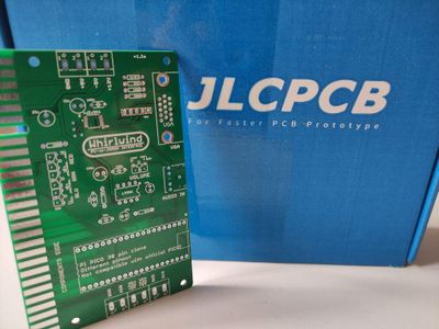

Manufacturing of Whilwind's printed circuit board (PCB) was sponsored by JLCPCB, a high-tech manufacturer specialized in the production of high-reliable and cost-effective PCBs.
Their customer service is fast and helpful and PCBs a great value for your money!
By registering at JLCPCB via THIS LINK (affiliated link) you will receive a set of coupons for your orders. Registering costs nothing, so it could be a nice way to give their service a due try ;)
Please, let me stress out that this type of sponsorship is essential to experiment new solutions and share good quality and full working circuits and layouts. It allows testing a first prototype and then share a second (or third, or fourth...), improved and corrected revision of the board. This mechanism has a very positive impact in the quality and reliability of shared projects.
