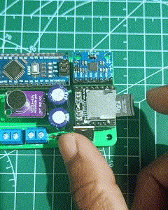

Sketching the circuit layout on EasyEDA, I strategically placed components for a snug fit inside the coffee mug. Incorporating terminal blocks for speaker connections and power supply, I ensured ample space for the MPU6050 and DFPlayer Mini.

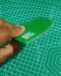

Step 2: PCB Design and Ordering
Converting my circuit design into a printed circuit board (PCB), I used EasyEDA for the design. After finalizing, I ordered the PCB from Lion Circuits for professional fabrication.

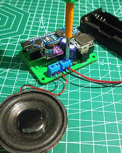

Step 3: Assembly
Connecting components per the PCB layout, I attached the speaker to the terminal block and powered the circuit using two 3.7V batteries regulated by the 7805. Ensuring proper grounding, I connected the DFPlayer Mini to the Arduino.

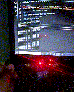

Step 4: Coding
Uploading the Arduino code, I tweaked track numbers, volume, and sensitivity thresholds to fit my preferences. The code seamlessly integrated MPU6050 readings with DFPlayer Mini commands, enabling playback control based on shakes.
Step 5: Circuit Calibration
Upon receiving the fabricated PCB, my focus shifted to calibrating MPU6050 values. This involved fine-tuning sensitivity for detecting shakes and adjusting threshold levels to match my desired settings.
Step 6: Testing and Final Placement
The testing phase was crucial to ensure that shakes triggered the desired responses. Fine-tuning both the code and calibration settings was necessary during this phase. With components secured inside the coffee mug and the speaker optimally positioned for sound output.
