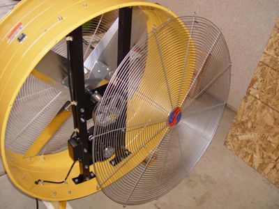

After doing a good bit of comparison shopping on the web we chose the Q Standard 36" belt drive drum fan model #10265.  The fan has a 2/3 HP 2-speed motor and delivers 11,200 CFM of air transfer which is more than adequate for our home.  We paid $307 (Northern Tool via Amazon) delivered to our door.  The cost per cubic foot of air movement is typically much better for drum fans than for whole house fans.   Our fan did arrive with a few dents and dings due to poor packaging.  But these were easily hammered out and made straight.

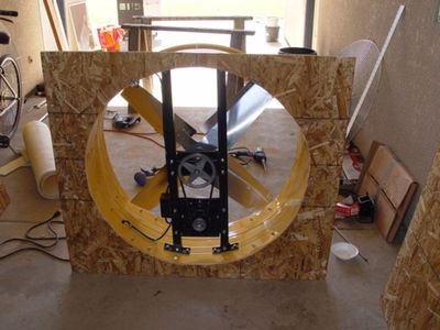

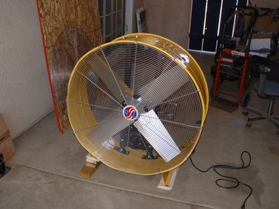

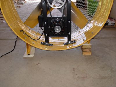

To mount this fan vertically and draw air up out of the house a large plenum must be built.   This can be constructed of sheet metal or plywood.   For our fan we used two 4x8 sheets of 7/16" USB plywood.   The first step in constructing the plenum is to remove any wheels, handles or fan guards that might be attached to the drum fan.  Then level the fan on a flat, level floor.  Note the stack of 2x4's used to get the fan mounting bracket to a vertical position.   Also note the closed cell foam under each foot of the fan.  The foam is used to help reduce vibration and noise transfer and must be in place during mock up and final assembly to insure the plenum opening will be at the proper height.
Step 2: Building the Plenum

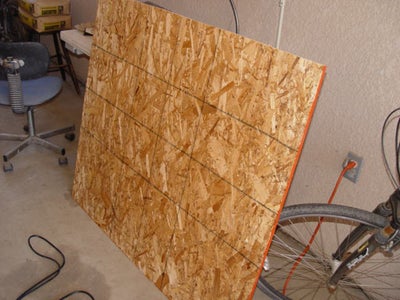

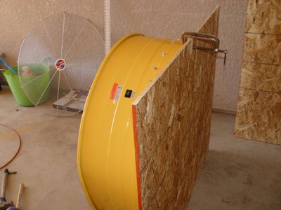

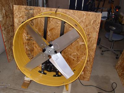

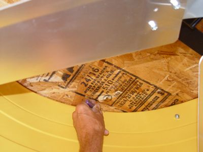

The front and the back pieces for the plenum are 42" tall by 47 7/8" wide (USB is not quite a full 48" wide).  Center the fan against the front USB panel piece and temporarily clamp it in place.  Make sure the panel is resting flat against the floor. Scribe a line on the plywood panel around the inside AND outside of the fan casing.
Step 3:

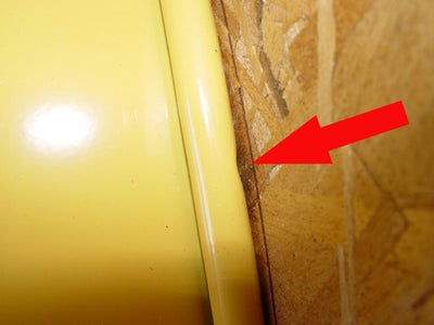

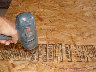

On the outside line mark each spot where the fan guard screws were attached.  There will be a slight indentation for each screw position as show by the arrow in the photo.  Make your mark as close to the center of the indentation as you can.
Remove the plywood panel from the fan and extend each of the marks you made and drill a hole half way between the inside and outside line.  For my fan the screws required a 5/16" hole.

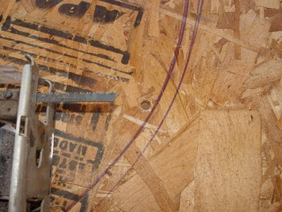

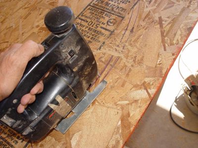

To cut out the opening for the fan, first drill a pilot hole just to the inside of the inner circle.  Then cut out the fan opening using a saber saw or sawzall staying just inside the inner line.   The plywood panel should look something like the final photo.

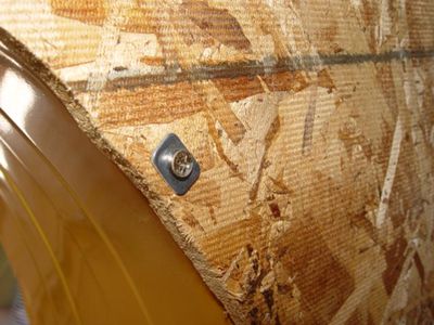

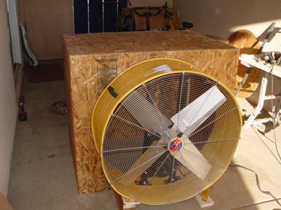

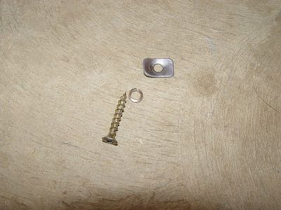

The screws which came with the fan for mounting the guard screen are not long enough to go through the plywood panel.   Substitute proper length screws (I used 1 1/4") and use the original flat washers and lock washers if possible.
Screw the plywood panel to the fan.
Step 5:

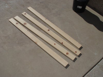

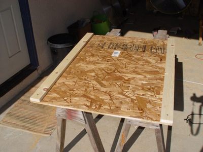

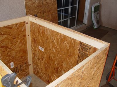

Cut four corner supports from 1x3 pine.   These supports will allow you to screw the four sides of USB plywood together.   The four corner supports are 41 9/16" which will allow you to install a 7/16" top on the plenum which will then end up flush with the side height.
Cut the side panels from USB and screw the corner supports to the edge of each panel.  The side panels for this plenum are 31 7/8" wide x 41 9/16" tall.  The width of the panel is determined by the width of your floor opening and the position of your floor joists.  So it may vary depending on your situation.  The finished plenum should sit directly on top the floor joists.

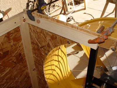

Set the side and rear panels together and screw pilot holes through the plywood at each corner so that the screw tips will hit near the center of the 1x3 corner support.  Cut and screw in place 1x3 supports for the lid of the plenum.  You will note that the front 1x3 support can not extend the full width of the plenum since it will interfere a bit with air flow at the top center of the fan.  So make the front support in two pieces with enough gap in the center so that the fan is not covered.  Also note that the 1x3 pieces are mounted 7/16" below the top edges of the front and rear panel.  This will allow the lid to slip down inside the box just far enough to make everything flush on the top.

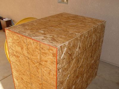

The plenum mock up now completed.  The unit is disassembled and all the inside surfaces are painted with a couple coats of flat black paint.   The paint is necessary to help protect the USB from moisture and will also prevent being able to see the inside of the plenum through the grate once the unit is installed.

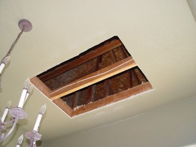

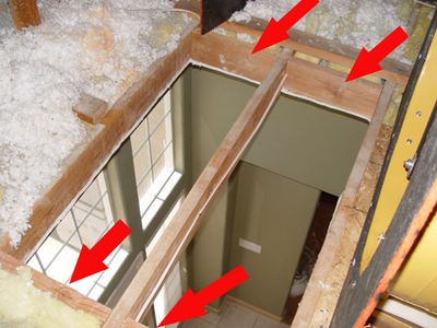

Cut out the plenum opening in the ceiling.  The opening is cut just to the inside of each ceiling joist and the center joist is left in place.  Our opening was 32" X 45".   The photo shows how the vent opening is framed out on each end with 2x6s (arrows).  A small platform of 7/16 USB is constructed in the area where the fan legs will rest.  The USB rests on 1x3 cleats which are set 7/16" below the top edge of the floor joists.  This allows the top of the USB to remain flush with the top of the floor joists.

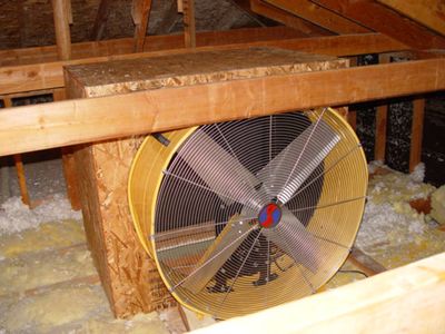

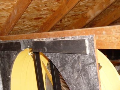

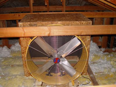

Most homes have very limited access to their attic areas.   In our case we had to move the fan and disassembled plenum pieces all separately into the space and then assemble them in the attic.  The fan unit is BIG, so make sure during your design and construction phases that you will be able to get the unit into position.  The fan unit is also relatively heavy.  So if you are lifting the unit up though your ceiling opening as we did, make sure you have some strong helpers.

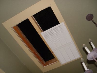

The electrical wiring is not shown since there are a variety of ways you may want to hook yours up.  We routed our wiring down through the ceiling into a closet and then hid our switch in there.   You can turn the fan on and off manually but it is much better to put it on a time so that it can be programmed to come on during the coolest part of the morning when you will probably be fast asleep.  We used a nifty timer switch from AutoChron (model #ACRT) that fits right over the top of traditional light switch and wall plate.

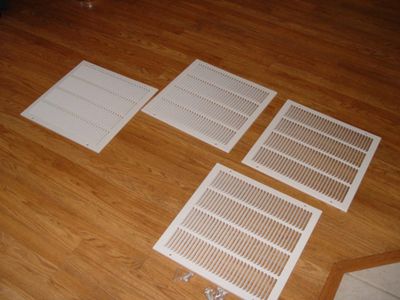

The hole to the plenum should be covered with a grate or grill.  We used six 16x16 metal grills from Home Depot mounted on a framework of 1x4 pine. During winter months when the fan is not needed, the grill should be covered to prevent hot air from escaping from the living area.   We use a simple panel made of 1" insulation and painted to match the trim of the house.
