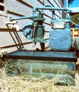

I didn't take photos of the assembly process, because to be honest I was winging it and wasn't sure it would work. Here instead is a shot with the parts explained.
You'll need:
1. An aquarium or reptile tank. Mine's about 10 gallons. I picked one with a screen top to prevent mosquito breeding. You could probably adapt the design to a hooded tank, though.
2. A low volume fountain pump. This one still has the fountain attached, but you could hook tubing to a bare one and install it in any kind of fixure you could think of. If you are just using an aquarium, you might be able to use the existing filter system and hack it to add an output.

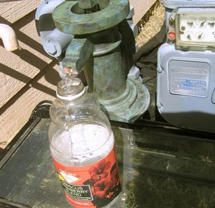

Step 2: Putting It Together
Hopefully it's pretty straightforward from the picture, but I'm happy to explain.
1. Find your condensate output. On an a/c unit, there will be a pipe coming from the house, usually near the compressor unit. On a swamp cooler, there will usually be a length of tubing. Position your tank so that it can receive the drip most effectively. The condensate will leak into the tank, slowly but quite surely. After a day or so, the tank will be nearly full. It's time to put that water to use.
2. Remove your screen, submerge the pump and make sure the output tube fits securely. Many of these have suction cups which will be helpful. Note that running a pump dry will damage it.
3. Modify the screen.
If you have a sliding screen use a file or rotary tool to carve out a pair of divots for the pump's power cord and the output tubing. I found that it produced a better fit, but didn't carve enough to prevent the tank from being useful in its original purpose. If you have a screen that clamps on, you could use pliers to give the power cord and tube somewhere to sit.
4. Position the pump so that it will flow back into your tank. In my case I found an easy hanging spot on the gas meter, and will probably secure it with wire.
5. Seal any gap between the screen and tank with duct tape. I prefer Gorilla tape because it has a longer life span outside.
You're done. Plug in your pump and you have a recycling fountain. Interrupt the flow with a bottle, and you have an easy way to water your plants.

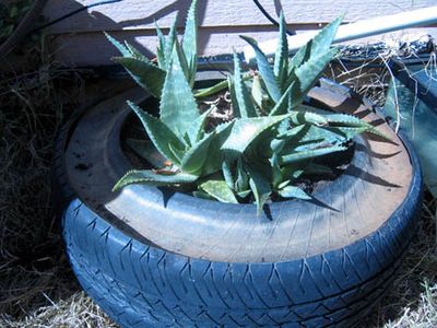

In the meantime, I've decided to simply divert the condensate, via pvc parts, into a homemade planter built from a used tire. I've transplanted aloe plants into fresh soil and I'll be monitoring them to see how they respond to the condensate. At least this way something's getting watered, the water doesn't go straight to my foundation, etc. One experiment begets another.
