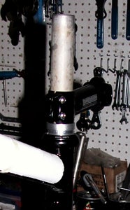

Step 3: Stem
Put on the stem with two spacers on top of the fork (with excess stem on the forks showing through). Use an allen key for this.
Step 4: Cut the Fork
Mark excess fork stem with a sharpie, take off the stem and put the fork in a vice grip (make sure to pad the forks).
Cut to size with a hacksaw with an even cut.

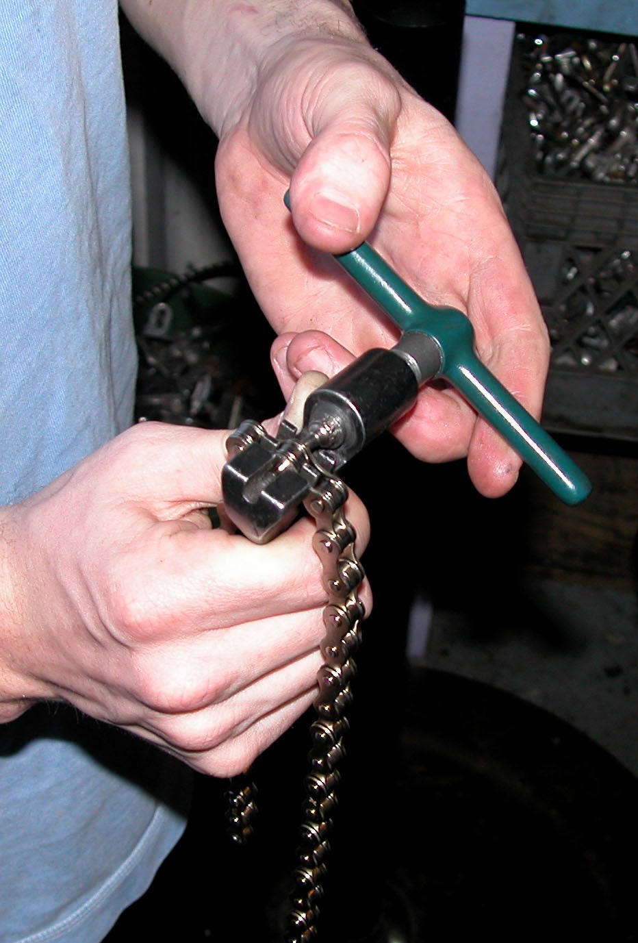

Step 11: Chain
To fit a chain over the chainring and freewheel, you should use a chain tool to take the chain apart and snap it back together after it is properly fit.
-Measure the chain to length with the rear wheel tightened in the middle of the back bracket. The chain should be taut with a little bounce. Use the chain tool to remove the pin halfway out of the chain, take out the unnecessary links and click the links back together (this part is not as easy as it sounds and you may end up with sore fingers) and place the pin back evenly into the chain with the chain tool.
