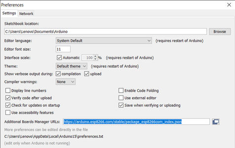

  1. Start by going to File> Preferences or by pressing Ctrl+Comma.
  2. Copy this link: https://arduino.esp8266.com/stable/package_esp826...
  3. Paste the link in the 'Additional Boards Manager URLs.

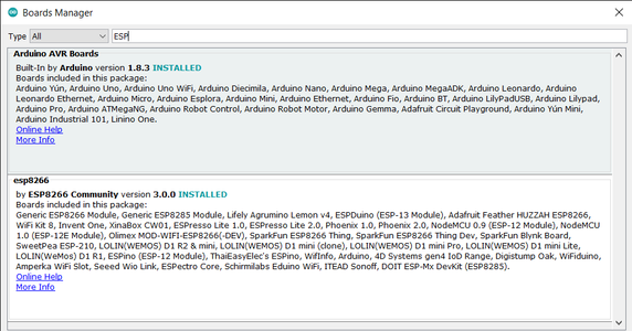

  4. Then go to Tools> Boards> Boards Manager and type in 'ESP' in the search box.
  5. Install the latest release of the ESP boards.

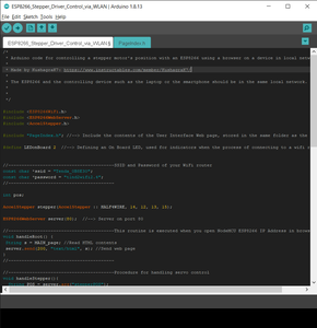

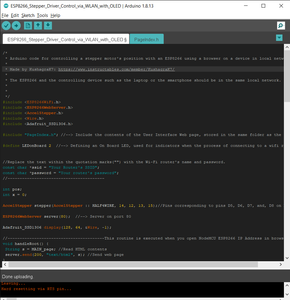

Step 4: Program the ESP Microcontroller
Depending on whether you are using an OLED display or not, you can choose which code to upload on the ESP microcontroller. You can get the Arduino codes from here.
Make sure to put the SSID(name) and password of your Wi-Fi router in the code.
