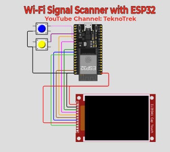

Step 1: Make the Hardware Connections
LCD Screen Connection:
Connect the SPI pins of the LCD screen to the ESP32. For example:
  1. VCC3.3V
  2. GNDGND
  3. CSGPIO 5
  4. RESETGPIO 4
  5. DC/RSGPIO 2
  6. MISO (SDI)GPIO 23
  7. SCKGPIO 18
  8. LED3.3V
  9. MOSIGPIO 19
Button Connections:
  1. Connect the first button between GPIO 0 and GND.
  2. Connect the second button between GPIO 15 and GND.
Jumper Wires:
  1. Organize the connections on the breadboard and power the ESP32.

Step 3: Testing the Project
Wi-Fi Scanning:
  1. Press the button to start the Wi-Fi scan. The LCD screen will display nearby Wi-Fi networks and their signal strengths.
Results:
  1. Check the signal strength and encryption types of the displayed networks on the screen.
