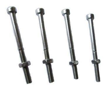

- M3 x 40 mm screws (x4)

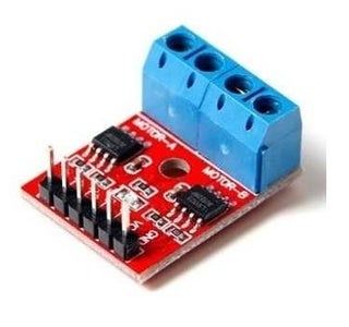

• H-bridge module (buy)

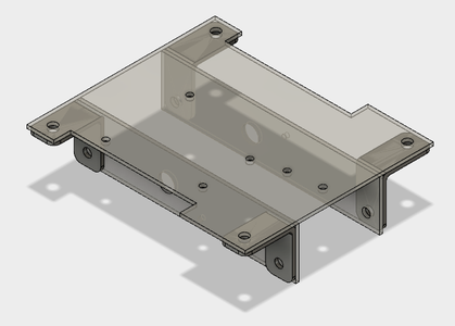

Step 4: Designing the Structure
First l had to design the mechanical structure of my robot. You might also buy the complete structure online if you doesn't want to build your own custom structure (there is a lot of robotic kits available online). In this case, you might jump to Step 6.
For this instructable, a low-cost acrylic frame was designed for the attachment of the motors and other components. The structure presented in this tutorial was 3D designed using Fusion 360 CAD software and constructed with ordinary tools (no 3D printer, laser cutter or CNC router needed). You might use the same principles described bellow to design a custom structure that fit your needs.

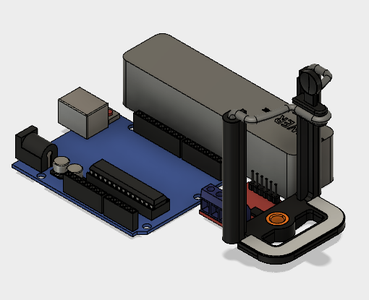

First I had to make a 3D model of the main components, in order to decide the arrangement of the structure. Some of them were downloaded from GrabCAD Comunity Library (https://grabcad.com/library):
- Arduino Uno (https://grabcad.com/library/arduino-uno-13)
- Gear motor (https://grabcad.com/library/bomotor-1)
- H-bridge (https://grabcad.com/library/motor-driver-l9110-1)
- Power bank (https://grabcad.com/library/power-bank-7)
- Universal phone holder (https://grabcad.com/library/universal-phone-holder-for-the-gopro-accessories-1)
The electronic components were arranged in a plane, so that I could figure out the footprint need for my robot. After that, I had to choose the position for the motors and wheels to create a stable structure.

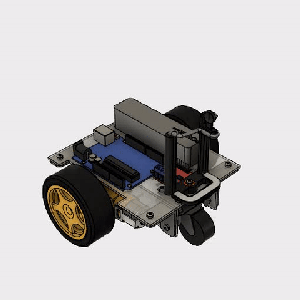

Based on that positions, the main structure was designed, which is composed of three plates (a base plate, and two side plates) which are connected using some brackets.

3. Mount the components with screws and nuts according to the 3D drawing:
Mount the components with screws and nuts according to the video, and your structure will be ready to go. M3 screws are used for the instalation of the brackets and DC motors. M2 screws were used for instalation of electronic components, while the 5/32" ones are used for the instalation of the front wheel and the smartphone clip.
