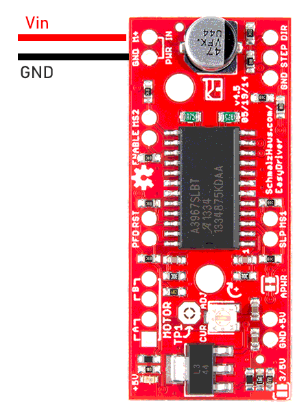

Step 5: Prepare the EasyDriver
Before we can start assembling the electronics, we need to get the EasyDriver ready. Unlike the Particle Photon that came with male headers pre-installed, we will need to solder headers onto the EasyDriver so it can be connected to the breadboard. Simply solder male pin headers onto all the positions around the periphery of the board.

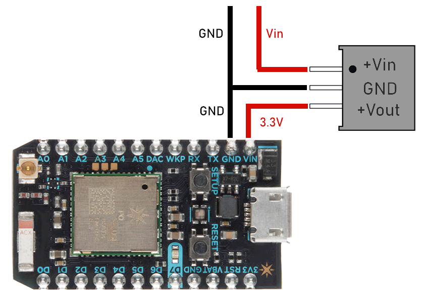

The trickiest part is placing the DC/DC converter onto the breadboard. On the side of the EasyDriver opposite the connections for the motor, you will notice a gap between the two sets of pins positioned in either corner of the board. We will take advantage of the absence of pins in this area to add the DC/DC converter to the breadboard. Plug the regulator into the breadboard in the row of pins closest to the power rail. There should be a gap just big enough between the EasyDriver and the DC/DC converter to add wires later on.
Why are we using the DC/DC converter?
We have a couple things going on with the power system in this design. First of all, the entire camera slider is powered from a 12V 2A power supply. The stepper motor is by far the most power-hungry component in this build. It can consume up to 1A all on its own. So, we need this relatively beefy power supply to feed the stepper motor.
The EasyDriver board is powered from this same power supply. The tricky bit is powering the Particle Photon. The Particle Photon runs on only 3.3V. Therefore, in order to avoid releasing the blue smoke from the Particle Photon, we need to step down the 12V power supply to 3.3V.
The EasyDriver actually has an on-board voltage regulator. There is even a jumper in one corner of the board for selecting a 3.3V output from the GND/5V pins right next to it. The issue is that stepping down 12V to 3.3V is too much power dissipation for this little linear regulator to handle and it will overheat. If you ever see your Particle Photon doing something like in the animation below, the regulator you are using to supply the Photon is overheating.
Fortunately there is a solution to this issue. The problem with using a linear voltage regulator is that they convert voltage by simply dumping the excess power as heat. If you try to put too much power through a linear voltage regulator it will overheat and shut down, like the above video shows.
Therefore, instead of using a linear voltage regulator, we will use a different kind of regulator called a switching regulator, which is also called a DC/DC converter. Switching regulators are able to change a voltage level while generating significantly less heat. Switching regulators are wired essentially the same way as a linear regulator. A high voltage goes in one side and a lower voltage comes out the other side, with ground connection in the middle.

We will start connecting all the parts by wiring the electrical system. First connect the DC barrel jack pigtail to one of the power rails on the side of the breadboard. From that connection, the power will branch into two paths. One will power the EasyDriver and stepper motor, the other will power the Particle Photon via the DC/DC converter discussed in the previous step.
Connect the GND power rail on the breadboard to the GND connection on the EasyDriver. Then, connect the positive power rail on the breadboard to the M+ pin on the EasyDriver.

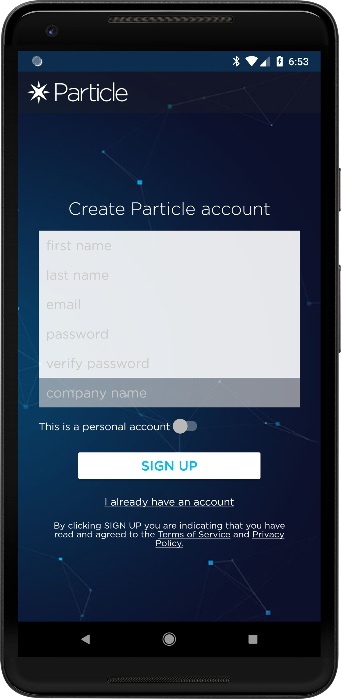

First of all, download the Particle app from the Play Store.

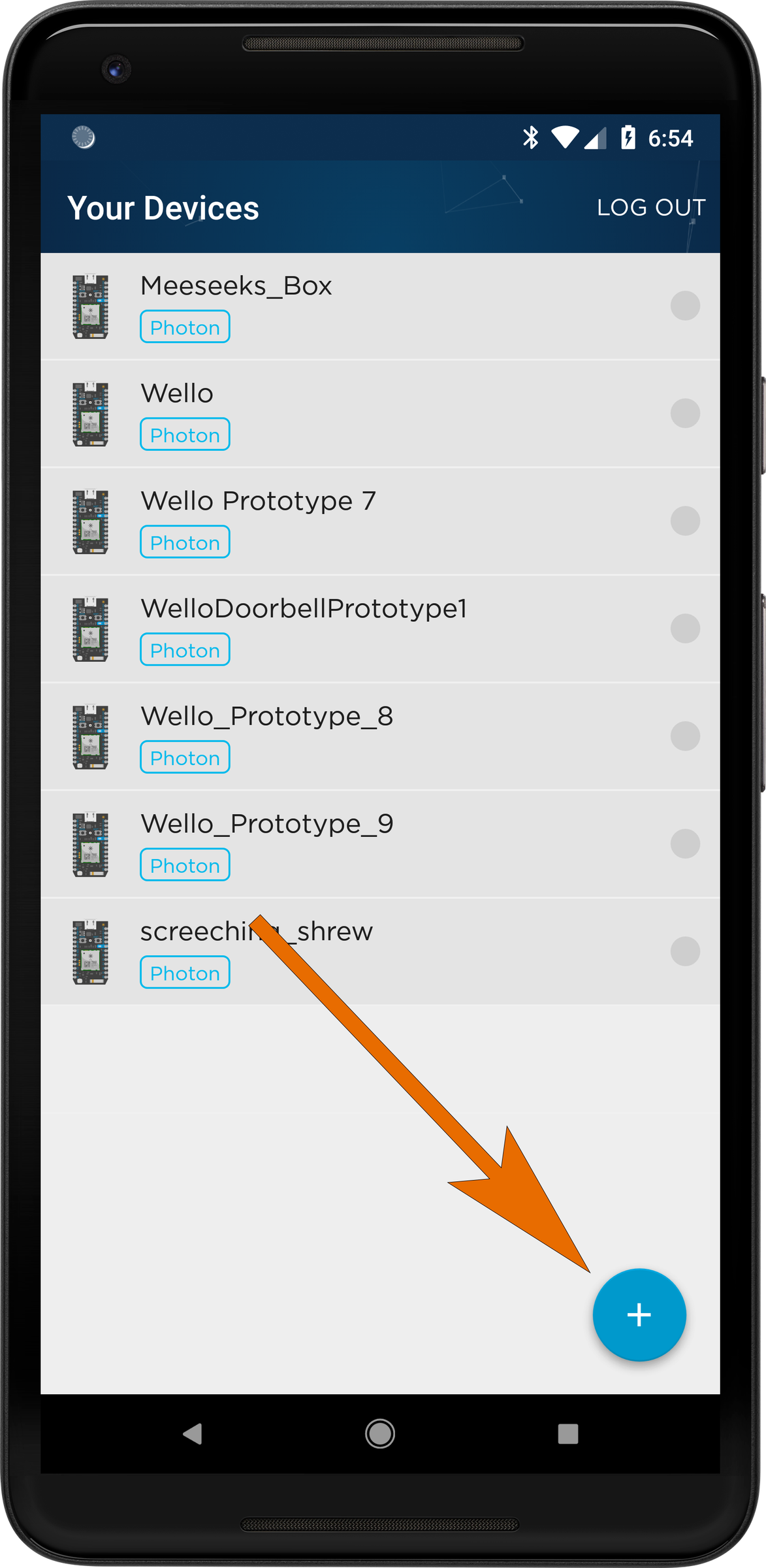

With the app open, first either log into your Particle account if you already have one, or register a new account if you've never used Particle before (if this is the case I think you will really enjoy using Particle, it is a great system).

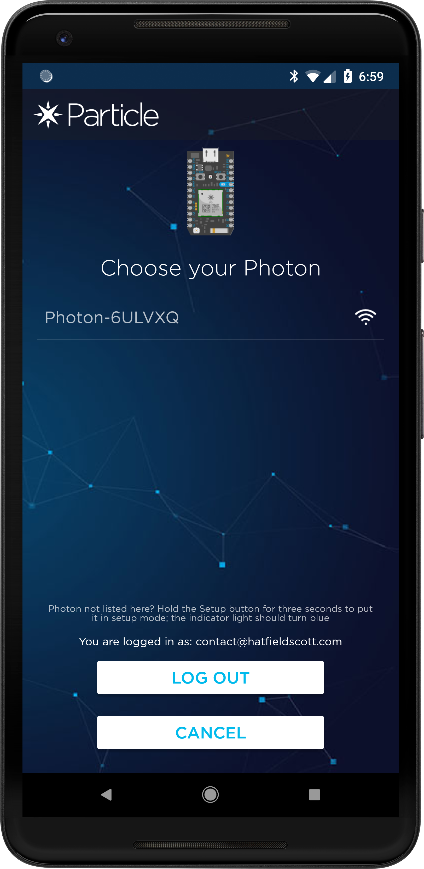

Once you get logged in, tap the + button at the bottom of the screen to add a new Particle device to your account.

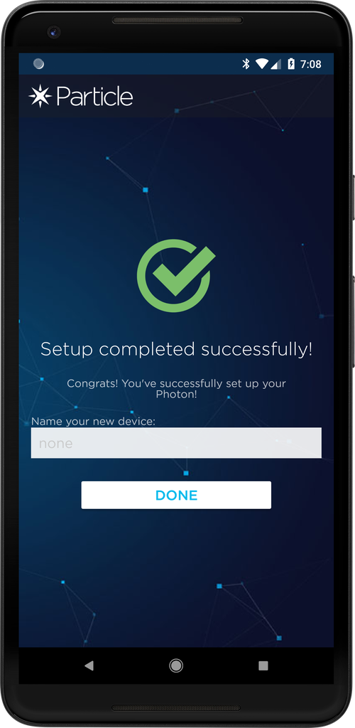

Now plug the power supply into the DC barrel jack to power on the Particle Photon inside your camera slider. Give the Photon a couple seconds to start up and then press the Ready button. The Particle app will begin searching for your Photon. Once your Photon appears in the list, tap it to begin setup.

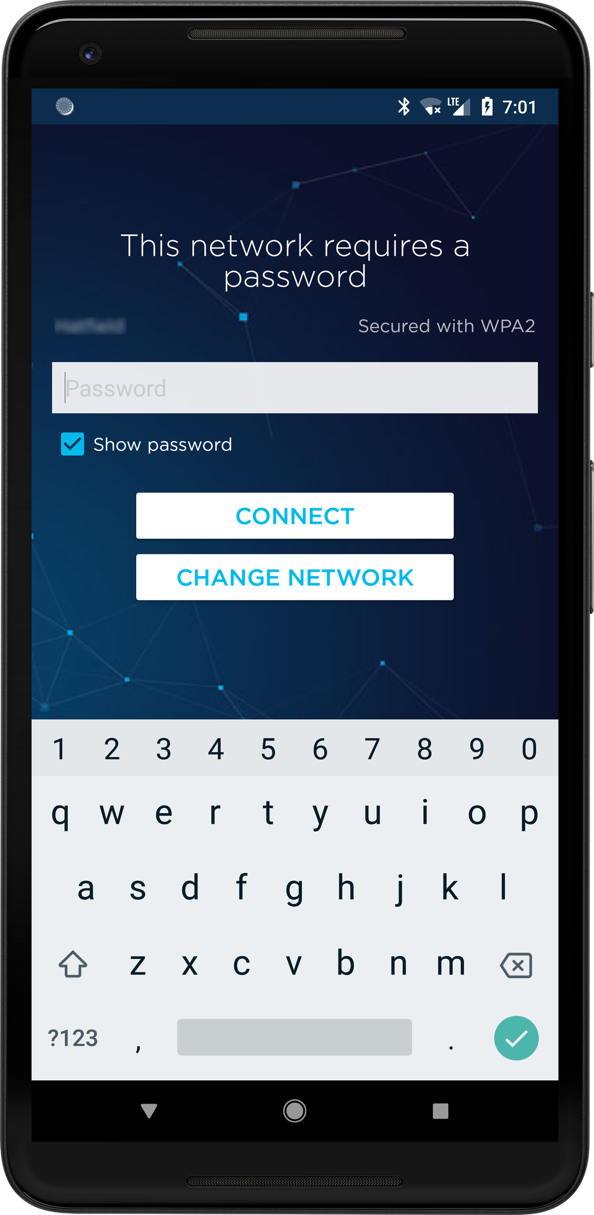

You will need to get the Photon connected to your WiFi network. The app will scan for available WiFi networks. Choose your WiFi from the list and supply the password.

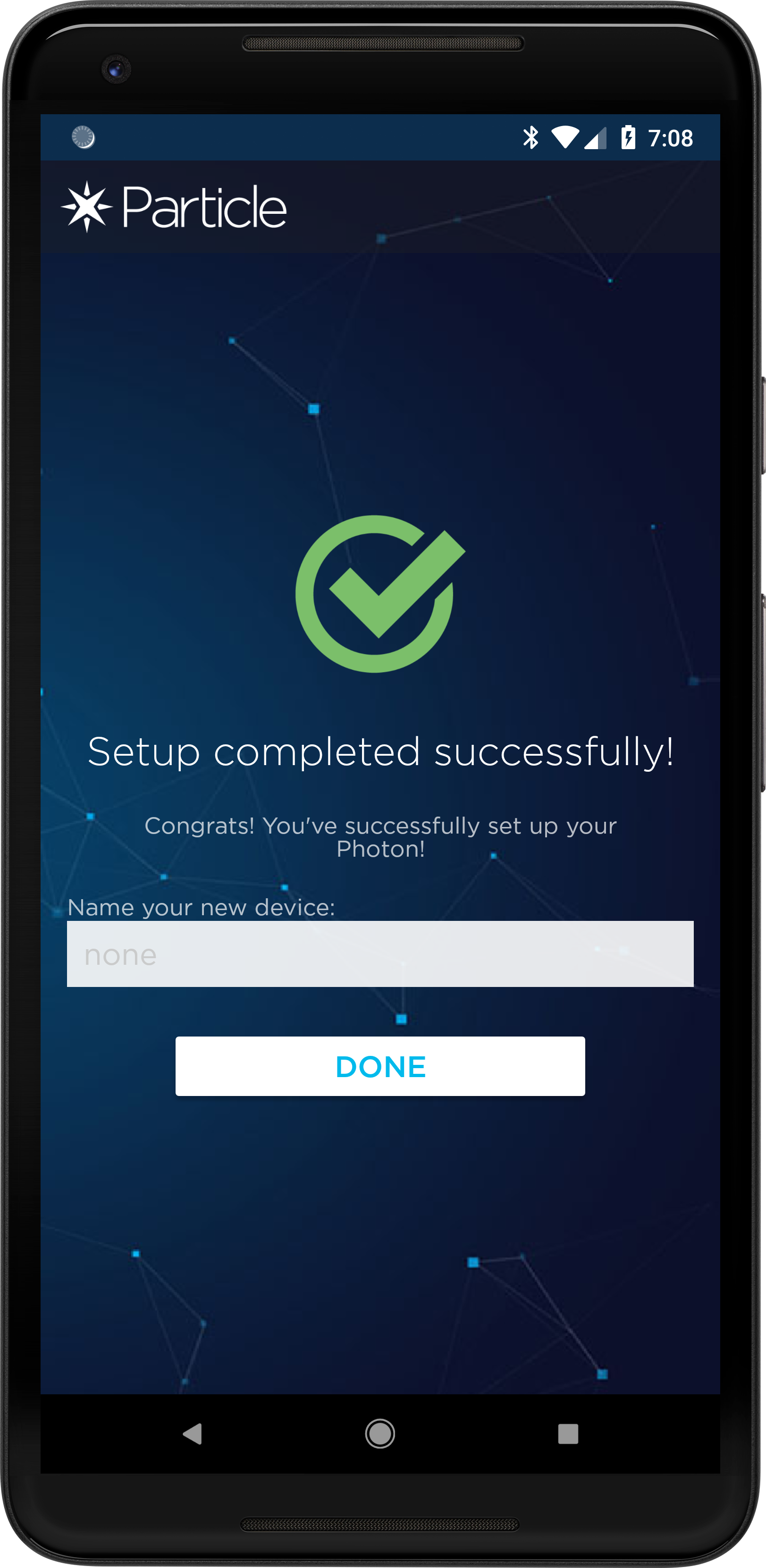

Once the Particle Photon connects to your WiFi network, the only thing left to do is give your Photon a name.

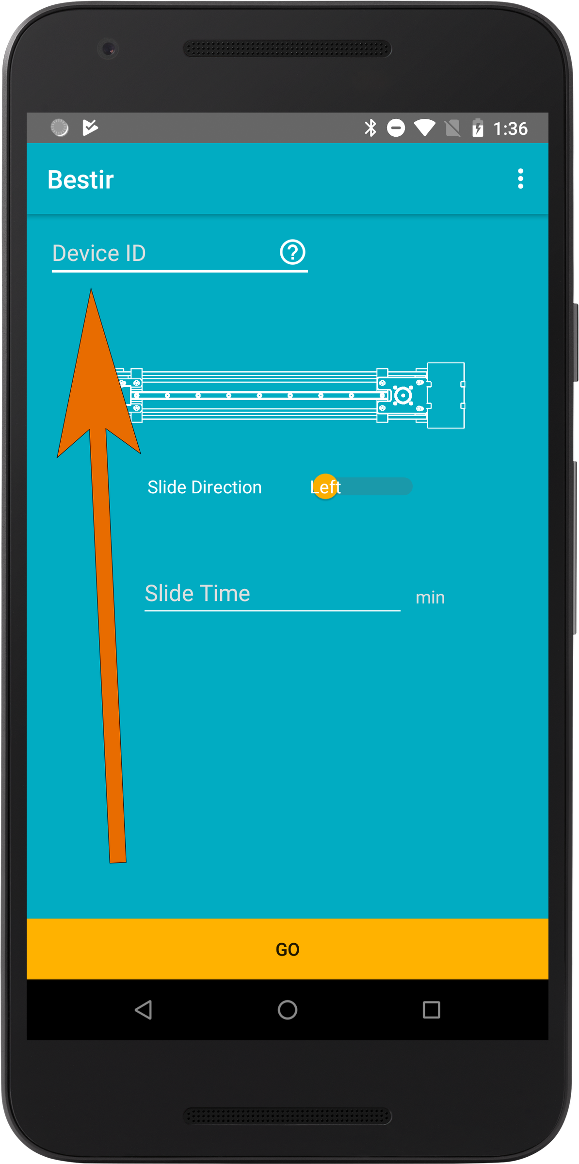

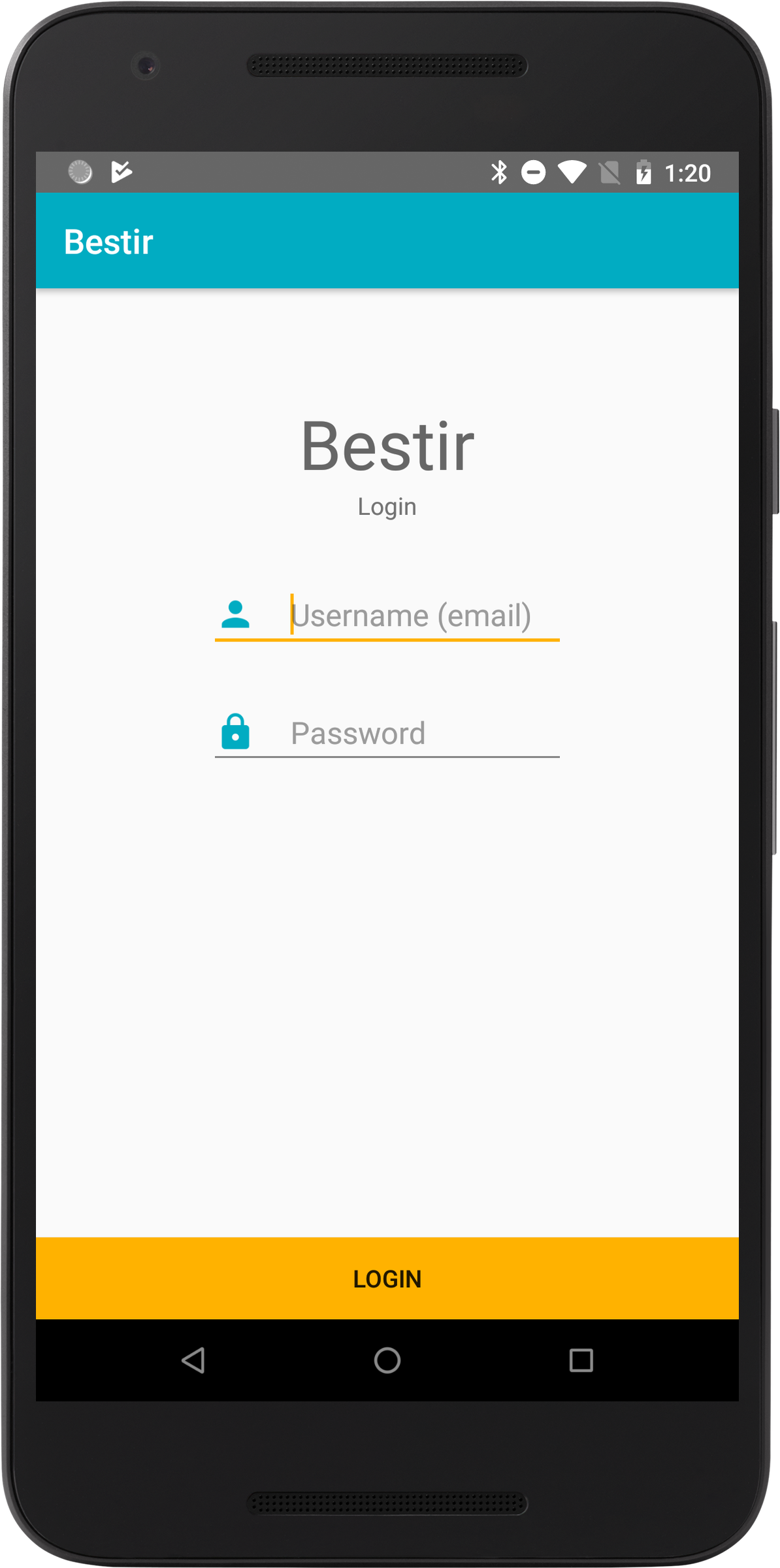

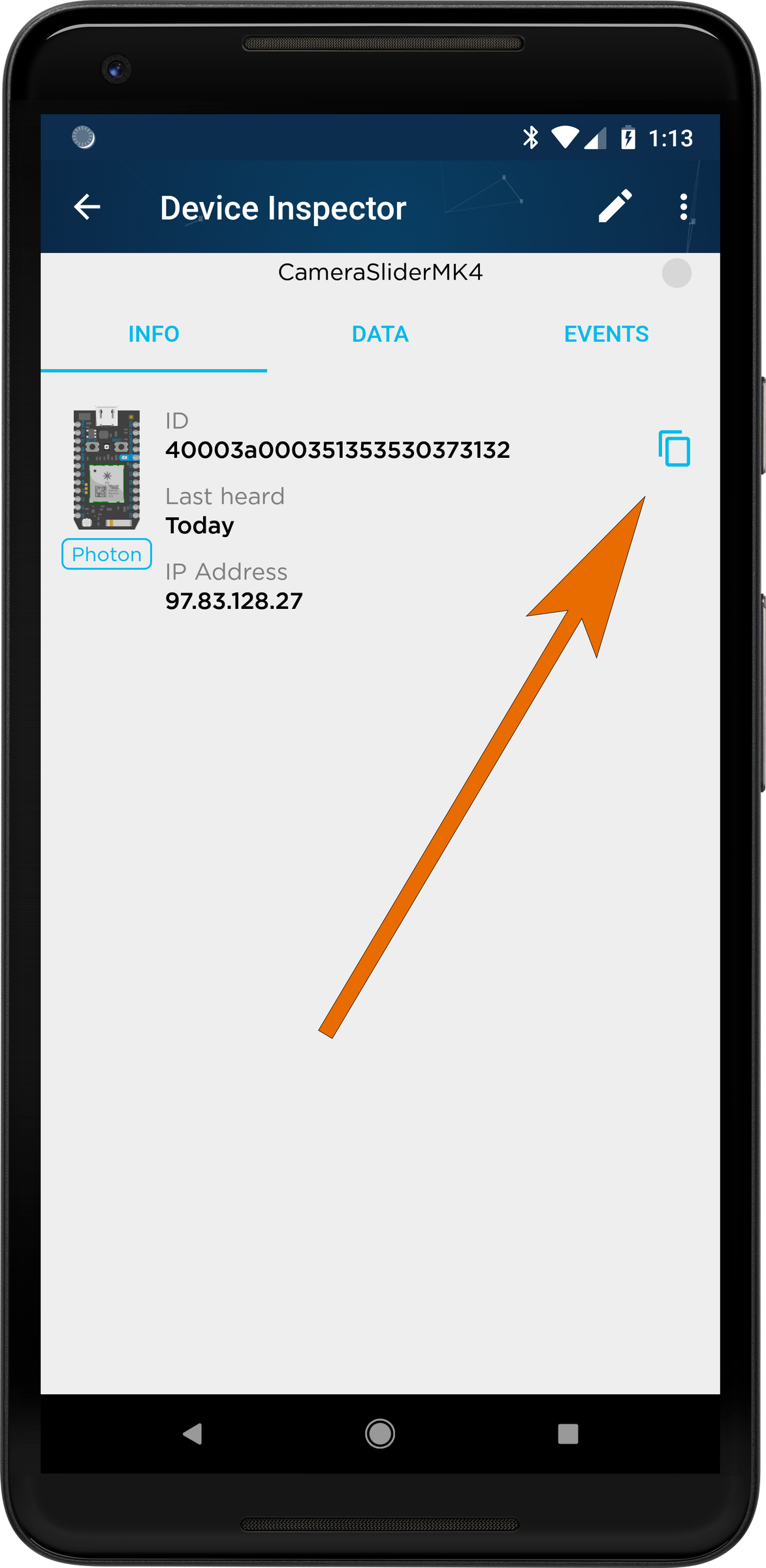

The application itself is fairly simple to use. You will need to get one piece of information before you begin: the ID of the Particle Photon inside the camera slider. To get this information, open up the Particle app again. In the list of Particle devices, select the one you added to your account earlier. The the Device Inspector you will find the ID of your Particle Photon. You don't need to bother writing this down though, next to this long number there is a button for copying the ID to the clipboard.
So take this copied value and open the Bestir app. The first step to using the app is logging in to your Particle account. In the Particle ecosystem you must be logged in to access cloud functions for your device which, as discussed in the previous step, is how the system works.
After logging in, you will be directed to the main part of the Bestir application. At the top of the page you will find a place to put the Photon ID we copied earlier.
With the device ID pasted into place, using the app to control your camera slider is as simple as telling the system in which direction to move, inputting the total length of time the move will take, and pressing Go.
