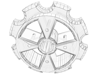

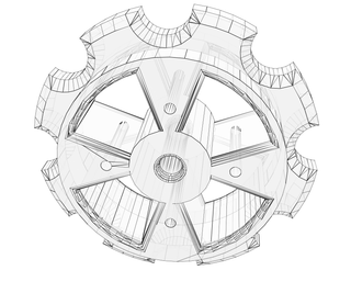

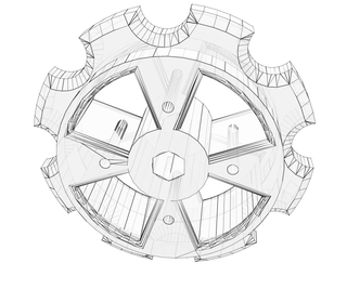

- Torso (1*)
- Front axis (2*)
- Front gear (2*)
- Back gear(2*)
- Middle gear (12*)

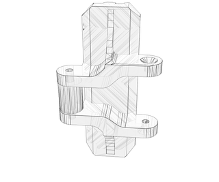

- Chain links (110*)

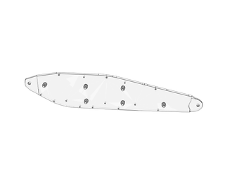

- Inner wall right (1*)
- Inner wall left (1*)
- Outer wall right (1*)
- Outer wall left (1*)
You should print these parts with an infill of over 15%. Print the walls with brim or raft because otherwise they sometimes start to lift a bit. All the chain links have to be printed with support and brim or raft. The torso also has to be printed with support.
*How often you have to print the part.

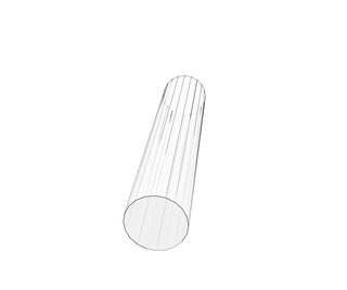

Step 5: Putting the Sidewalls Together
Take an inner wall and an outer wall from the same side. Put nails through every hole at the marked places. Push the gears with the small holes on the nails. Then take the front axes and push them in with the gear. After that put the inner wall onto the nails and push it carefully until it is in its place. Then cut the protruding ends off. Repeat this process for both sides. Be careful when cutting because of the flying metal parts.

Step 7: Connect the Sidewalls With the Gearbox
Take a candle and hold it under the metal axes of the gearbox and heat them a bit. Now take the back gear and hold it between the connected sidewalls at the end. Push the hot end of the axes through the hole in the back gear and repeat this process until it fits very well. Now repeat it for the other side.

Step 9: Build the Chains
Take two cleaned(the support is removed) chain links and push the thin wires throw the four holes. If the wire don't go throw take a 1 mm drill and try to remove the filament, that prevents the wire from going throw. After this, bend both ends of the wire until the wire can't fall out and cut the ends with a plier. Now you have to do this for every chain link. For me, this process took over 4 hours. So bring some time with you.
