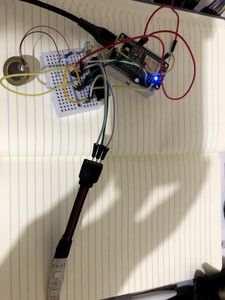

Step 2: Connect the Circuit
Connect the circuit as per the diagram above. We need 3 MOSFET to power the 3 colours (RED, GREEN, BLUE) of the LED. Note that I am not using the individual addressable LED strip. For that you will need a different connection.
Using the 3 colours of the LED, we are able to create many more colours. For educational purposes, it is great to be able to teach the kids about the Primary colours, and the combination that made up the other colours.
Another thing to note is you will need to make sure that the GND of the 12 V power supply is connected to the GND of the 5V power supply. Another alternative is you can use the 12V power supply to power the 5V using the 5V regulator LM7805.

Step 4: Upload the Code to ESP8266
Once you have configured the code to suit your WiFi setup, it is time to upload the code to the ESP8266. Make sure you select the correct port where your ESP8266 is attached to. In the example above, I have mine on /dev/cu.wchusbserial14750, this might be different from your PC or Mac.
Then Select Sketch->Upload.
Wait until the upload is finished. If all goes well the ESP8266 should connect to your WiFi router and have the IP address of 192.168.1.111. This might vary if you have change it in the previous step. Point your browser to that IP address, http://192.168.1.111, you should see the LED remote control as shown in the picture.
Click on the colour to change the colour of the LED according to your mood, and enjoy.
