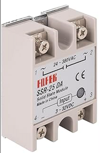

U1) Solid-State Relay...
The solid-state relay (U1) is what allows the low-powered ESP to control the high-powered outlet. It is a fairly basic circuit component so there really isn't much I need to say about it. It hooks up directly to the ESP and then to ground.

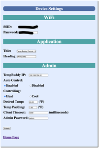

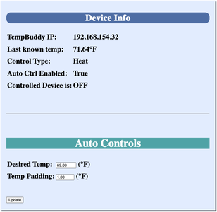

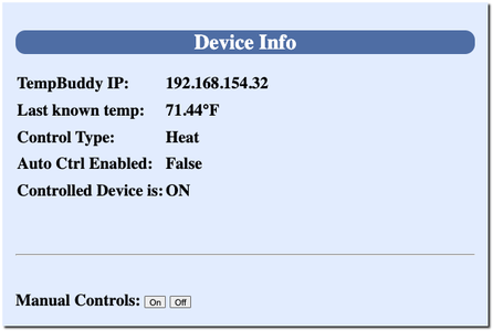

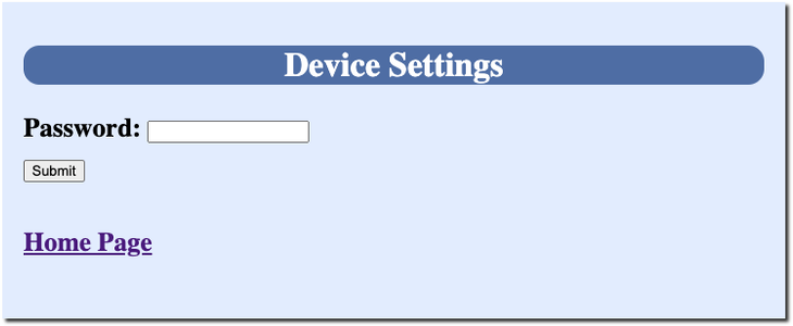

Step 4: Configure the Device
Once the device is programmed and running for the first time, you should find that it transmits a WiFi network called 'TempBuddy_Ctrl'. You can connect to the network from a computer or smartphone without using a password. Just keep the password field blank. Once connected you may have to tell our phone or computer to stay connected to the network despite not having Internet access. Then open a web browser and navigate to http://192.168.4.1/admin. Once there you will see a page requesting a password. Simpy use the default password 'admin' and it should take you to the settings page. Once at the settings page you can configure the device to join a local WiFi network as well as make some other adjustments and customizations. Once you save the settings, if you updated the WiFi settings then the device will reboot and join the desired network. Give the device 5 to 10 seconds after reboot to join the network and then use the Reset button to either get the last octet of the IP Address it obtained using a quick press, or using a long press of 6 seconds or more you can obtain the full IP Address. Once you have the IP Address for the device, simply open a web-browser on any computer or smartphone on that network and type in the IP Address for the address and you should be greeted with the Information Page where the device's information is listed and there should be Manual Controls at the bottom of the page if not in Automatic mode, or special controls for Automatic Mode's temperature settings if in Automatic mode.

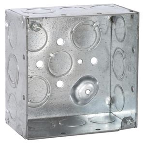

Step 5: Building the Final Version
Before attempting to assemble the final version of the device, try to place the components into the box and get a feel for how they will be arranged to fit properly so the box can be assembled with everything fitting.

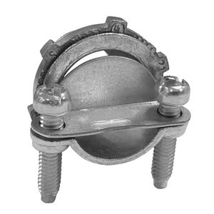

Step 6: Add Cord to Case
As can be seen in the above image, the cord is cut and stripped back so that the individual wires are exposed. Pictured here are 3 wires as it is a 3 pronged plug. The green wire is attached to the ground prong. The brown wire was attached to the hot prong. The blue wire was attached to the neutral prong. I used a multimeter to ensure which wire was connected to which prong. It is important for the safety of those who may be exposed to the device during operation that the wires be determined and used correctly, some feel that hot and neutral are interchangeable but really it is unsafe to do so, for reasons that are beyond the scope of this tutorial. As you can see if you zoom in on the picture, the cord is secured to the box using one of the 3/8" Non-Metallic (NM) Clamp Connectors.

So I used something called Alien Tape to attach the relay to the bottom of the box but really any strong double sided tape could likely be used. Just make sure the High Voltage side of the Relay is facing the more open part of the box as it will need more room for the connecting wires and such.
Wiring up the Cord...
As you can see from the picture, I also wired up the cord to the USB Power Supply, Relay and Outlet. To wire up the cord I attached the brown (hot) wire to one of the terminals on the switching side of the relay, also connected to that same terminal is another piece of the Brown wire which connects to the smaller post of the USB Power Adapter. I soldered the wire to the post of the power adapter and placed some shrink tube on it to cover all the exposed metal to prevent shorts. Next I cut the Blue (neutral) wire and attached a bit of it to the remaining post on the USB Power Adapter and used some shrink tube to cover the exposed metal. Then I soldered the incoming blue wire to the blue wire that was attached to the USB Power Supply along with a third piece of blue wire and covered the connections with shrink tube. Finally I attached the other end of the additional piece of blue wire to the neutral side of the outlet. At this point the USB Power Supply is now connected to be powered up whenever the device is plugged in regardless of the relay's switched state. Now to connect the Black (sometimes hot) wire as shown in the picture. I used black wire because I ran out of the brown and black is normally used in house wiring scenarios to indicate the hot wire. One side of the black wire connects to the currently empty terminal on the switching side of the relay and then the other end of the wire attached directly to the hot side of the outlet. At this point to complete the high-voltage wiring only one more wire needs connected. The ground wire (Green) needs connected to the grounding terminal on the outlet. I would say to also connect it to the metal box too, but when the adapter plate for the outlet is attached and the outlet is mounted, ground will be electrically connected to the entirety of the box anyway.

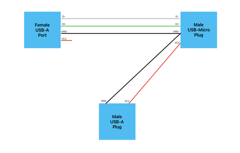

Step 11: The Later Added USB Port
Ok, so like I mentioned before, I ended up adding a USB port for programming the device without taking it apart. To do this I salvaged a Female USB-A port from an old device I had sitting around the house. This is when things got tricky and a little aggravating for a while. Turns out that Female USB-A ports are meant to be used on the Computer or Power supplying end of things. You see I figured I could use it on my device and then just use a USB-A to USB-C cable and connect the USB-C end of the cable into my computer and the USB-A Male end of the cable to my device. Nope!!! Turns out that's where things get complicated. Well, I liked the size of the USB-A Female Port and it fit nicely into the design of my device as you can see from the pictures above, so I wasn't willing to use something else so I made it work.
Long story short...
I had to build (splice together) a special cable that is USB-A Male on both ends. One end I can plug into my device, the other end I can either plug into a USB-A port on my computer or I can place a USB-C adapter on the end of the cable and then plug it into my computer's USB-C Port. This cable was made by cutting the micro ends off of two 4 wire USB-A to USB-Micro cables and then soldering the Red wires together, the Black wires together, the White wires together and the Green wires together. Then I finished the cable off with shrink tube to cover the splices.
Internal Mods for External USB Port...
In order for the USB port to be able to be used to program the ESP. I changed the design of the cable that runs from the USB Power Supply to the ESP such that the cable now looks like a 'Y'. One end of the new cable plugs into the USB Power Supply, another end plugs into the ESP Device and the 3rd end is connected to the USB-A Female port. I have attached a diagram of what this adaption looks like electrically. One important note is that, with this adaptation the TempBuddy Control Device must be plugged into a wall outlet while programming the device. The ESP will not be getting its power from the computer while programming.
