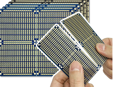

Step 2: Build the Circuit
Temporary Proto-Board Build...
Well, this part was pretty simple. I simply had to implement my design on a temporary proto-board. So I had a prototype of the circuit I could interact with, test, and fine tune if needed. Turns out the circuit was a pretty simple one so I really didn't need to change much, although this is actually the step where I not only decided to add the Factory Reset button and capability, but also realized through interactions that in practical use the device wouldn't be setup though the serial connection with my computer so I needed a way to get the IP Address from the device directly, and that is when the multi-purpose nature of the Factory Reset button came to be.
