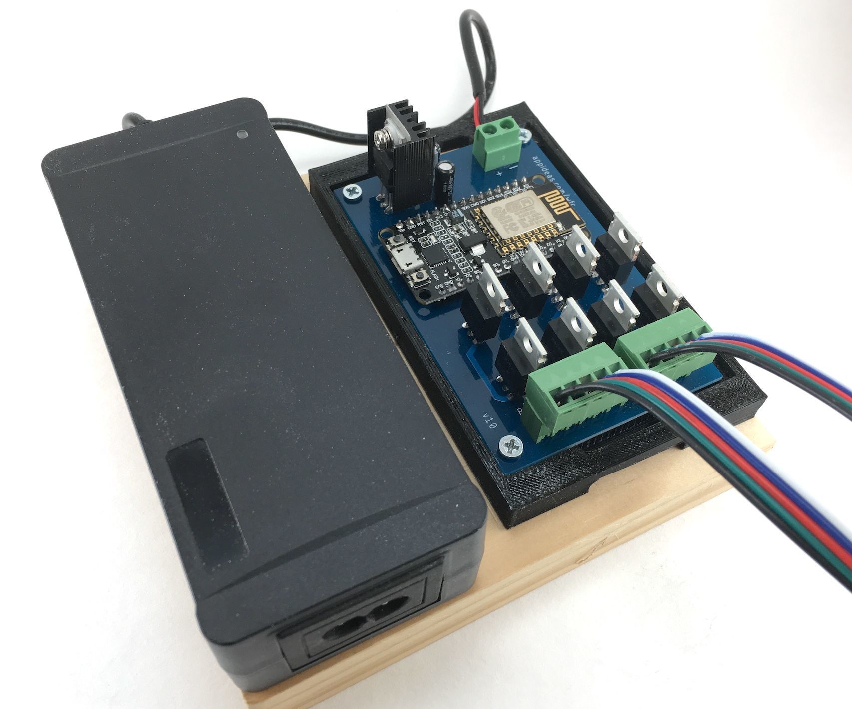

Method 1: Make a custom PCB with a CNC router. Download the CNC router zip file at the bottom of this step and unzip the file. Use the contained gerber and excellon files to generate the tool paths for your bits and gcode for your CNC router, and you’ll have PCBs specifically for this project (several are pictured in the images for this step). If you have a CNC router and haven’t cut a PCB before or don't know how to generate your own tool paths, check out my Instructable on the topic. That process really requires its own Instructable, which is why I wrote one. It's also why I can't provide all of those details here. This is, by far, the best way to go if it’s an option for you. If it's not an option for you, skip ahead to method 2.
If you make the PCBs I provide and want to use the cases I made to contain them as well, cut the PCB out of your workpiece along a bounding box, with rounded corners, that has a 3 mm margin. I use FlatCAM to generate the gcode for my router, and full instructions for this specific board cutout are available in step 5 my previous Instructable. FlatCAM settings are covered in step 4. (Instructables link)
You’ll notice in the pictures that I split this into two PCBs - one for the microcontroller and its associated components, and the other for the MOSFETs. I couldn’t figure out non-crossing trace paths for 8 MOSFETs on the same single-layer PCB as the microcontroller, and the easiest solution my limited experience enabled me to imagine was to was to split it into two boards and “jumper” the boards together. If you’re doing this as a perf board/strip board project, crossing wires won’t matter, and you should be able to fit this all onto one PCB. However, it may help you keep things organized if you split it up the same way I have.
There really isn’t much instruction to give for this method of making the electronics for the controller. What you need to do will be pretty obvious. Once you have the PCBs, populate them with components (refer to the fourth through seventh images above), solder the pins to the appropriate pads, then connect the two PCBs to each other with jumpers. I did that by soldering wires directly to the boards.
Note from the sixth image, the order of the wires coming out of the MOSFETs to the lights (indicating which color of light each MOSFET is, um, FETing its MOS upon). Also note the order of the wires coming out of the FET board and going to the MCU board (sixth image), and the order of the wires going into the MCU board and coming from the FET board (fourth image). If you mess those up, you’ll be able to correct the mistake later in software, but it will be a little more straight-forward if you keep them in the order shown. I intended for the MOSFETs and the pins on the ESP to follow the same sequence of colors as the lights - W, B, R, G. In order to make all the traces come out correctly, the jumpers coming out of the FET board are in this order: White, Blue, Black (ground), Green, Red. Refer to the pictures while you're wiring that part.
I have a few final notes for you if you are making PCBs with a CNC router for this project:
One thing I do as the result of “learning from experience” is to super glue the screw-down terminal blocks to the PCB. (Amazon link) A good alternative is to skip the terminal block and solder all those wires directly into the PCB, but I often times regret not having easily pluggable/unpluggable power and ground in my projects. Terminal blocks take a lot of abuse because you often need to really tweak on them to get them to hold everything captive. The pressure required to screw those down often times causes solder points to pop loose. I’ve even had it delaminate copper from (tear the copper from the surface of) a PCB! When I add a drop of super glue to the terminal block while mounting it to the PCB, that particular concern goes away.
For now, I leave the outputs from the MOSFETs that are headed for the strips of lights as bare-ended cables. I find it easier to solder separate cables onto the lights, then join the light cables with the FET board cables using wire nuts (temporarily) or soldering the wires together and protecting the solder points with liquid tape and heat shrink tubing (permanently).
If I'm powering the electronics and the lights with the same power brick, and I am using a standard 5-strand cable going to the lights, I connect the BLACK wire to a +12V connector on one of the PCBs. The black wire leading to the lights is for power, not ground! See the final photograph above.
