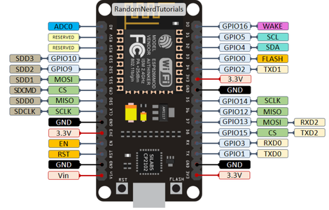

Step 2: Assembling the Board
Wiring The OLED:
  1. SCL to pin D1
  2. SDA to pin D2
  3. VCC to 3V
  4. GND to Ground

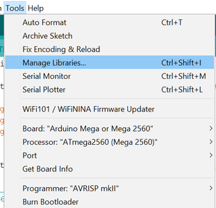

Step 3: Install Required Library
Library Required:
Please install the following library in the library manager.
#include <WiFiManager.h>
#include <Wire.h>
#include <Adafruit_GFX.h>
#include <Adafruit_SSD1306.h>
