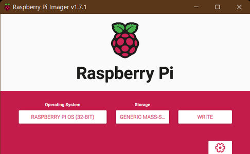

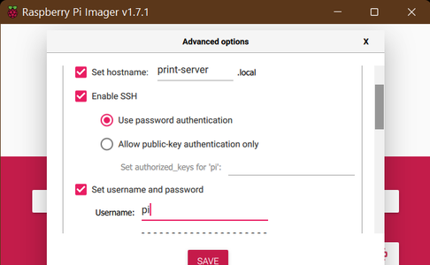

Download RPi Imager:
https://www.raspberrypi.com/software/

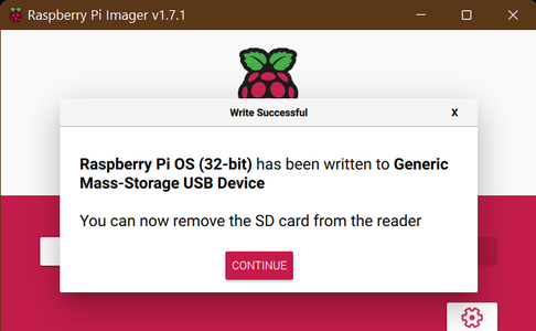

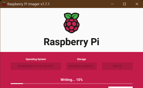

Launch. Select the desired OS image. (I chose RPi OS Lite, 32-bit, for the Zero.)
Click the gear icon to get to Advanced Options. Scroll to see all options.
- Turn on SSH.
- Hostname to "print-server".
- Set RPi un and pw. We are using "pi" for the username.
- Set Wifi, using 2.4 signal if you're using a Zero.
- Set locale.
"WRITE" OS to the card.
Go make coffee.

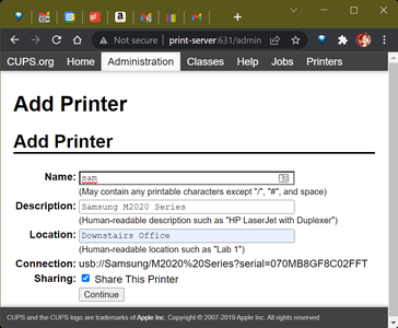

- Click the "Add Printer" button.
- Log in using your RPi un (pi) and pw.
- Select your printer from local printers. Continue.

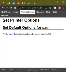

- Fill out names as you prefer. I named my printer "sam". Check "Share This Printer". Continue.
- Find your Make. I uploaded a PPD file for a similar model Samsung printer (Samsung-M2022W-splix.ppd) which I dug up from a Google-cached version of a page on OpenPrinting.org. Continue.

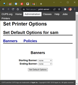

- Set printer options. I kept defaults.
- Now you're under Printers menu. Administration pulldown > Set as server default.
- You're done here.

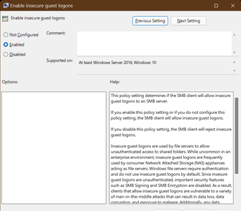

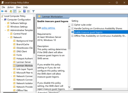

Enable the insecure guest logon:

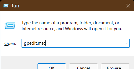

- ⊞ Win+R > gpedit.msc
- Local Computer Policy > Computer Configuration > Administrative Templates > Network > Lanman Workstation > Enable insecure guest logons > Enabled > OK.

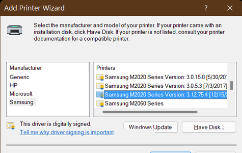

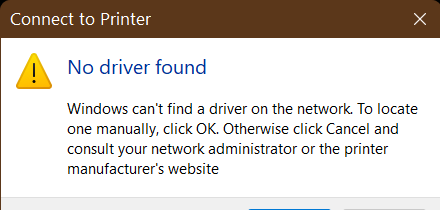

rundll32 printui.dll PrintUIEntry /in /n \\print-server\sam
- Choose a print driver using the wizard.
- Set as the default printer in Windows. Print a test page.

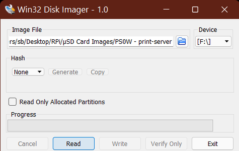

Step 7: Back Up Your New MicroSD Card
Now that you're finished with the installation and configuration, it's a wise idea to make a .img backup of the card. In Windows, use the "READ" function of Win32 Disk Imager. (I had to quit out of Google Drive before that app would open in Windows 11.)
For me, the writing process took a bit over one minute per GB to complete. (I recommend a 16GB card because a bigger card will only take longer to write the OS to and to back up, and will forever take up more storage space for the backup img.)
In case of need, you can use RPi Imager to burn that .img file to a new MicroSD card and you'll be back in business.
