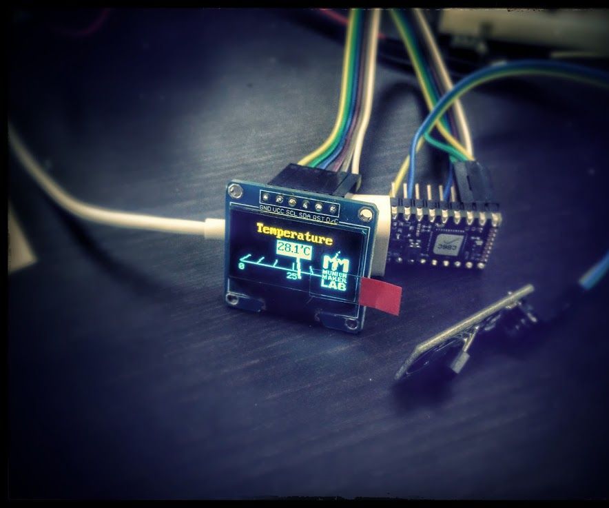

As I wrote at the beginn of this short instructable, this is just the base.
But you can make many funny projects by using this hard and software.
For my next project I'm using not only the RFID module (SPI), I will use a small OLED display (I2C), and toggle button.
The boxes are fully self configurable by one master RFID card.
There is also a webinterface to manage all boxes and add some topics, tags and description.
If I'm finished the project, I will upload it to instructables - so stay tuned.
There will be also a link here to the new tutorial.
