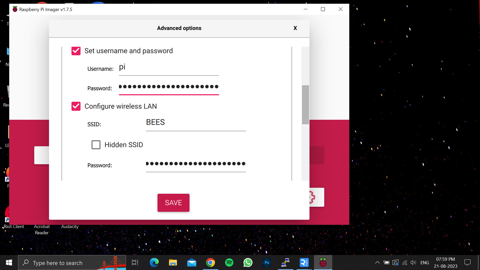

Step 1: Setting Up the Pi Zero 2W
First, we need an SD card for the Raspberry Pi. Since we don't have a lot of code for this project, you can use a relatively small 8GB microSD card. Download the Raspberry Pi Imager to flash the OS onto the SD card. Insert the SD card into your laptop's SD card slot.
In the app, go to Raspberry Pi OS (other) --> Raspbian OS Lite (32-bit for Pi Zero W, 64-bit for Pi Zero 2W). Choose the SD card you just inserted.
In Settings (bottom-right corner), set the hostname to raspberrypi.local, enable SSH, set the username and password to anything you like (this will be used to log into the Pi Zero), and configure the WiFi SSID and password.
Finally, click "SAVE" and then click "WRITE". Be careful not to remove the SD card or turn your laptop off during the flashing process, as this will corrupt the card. After the flash is done, you can remove the SD card from your laptop. Insert the SD card into the Pi with the pins facing down, connect the Pi to power (5V microUSB adapter), and wait for it to boot up (approx. 3 minutes for first boot-up).

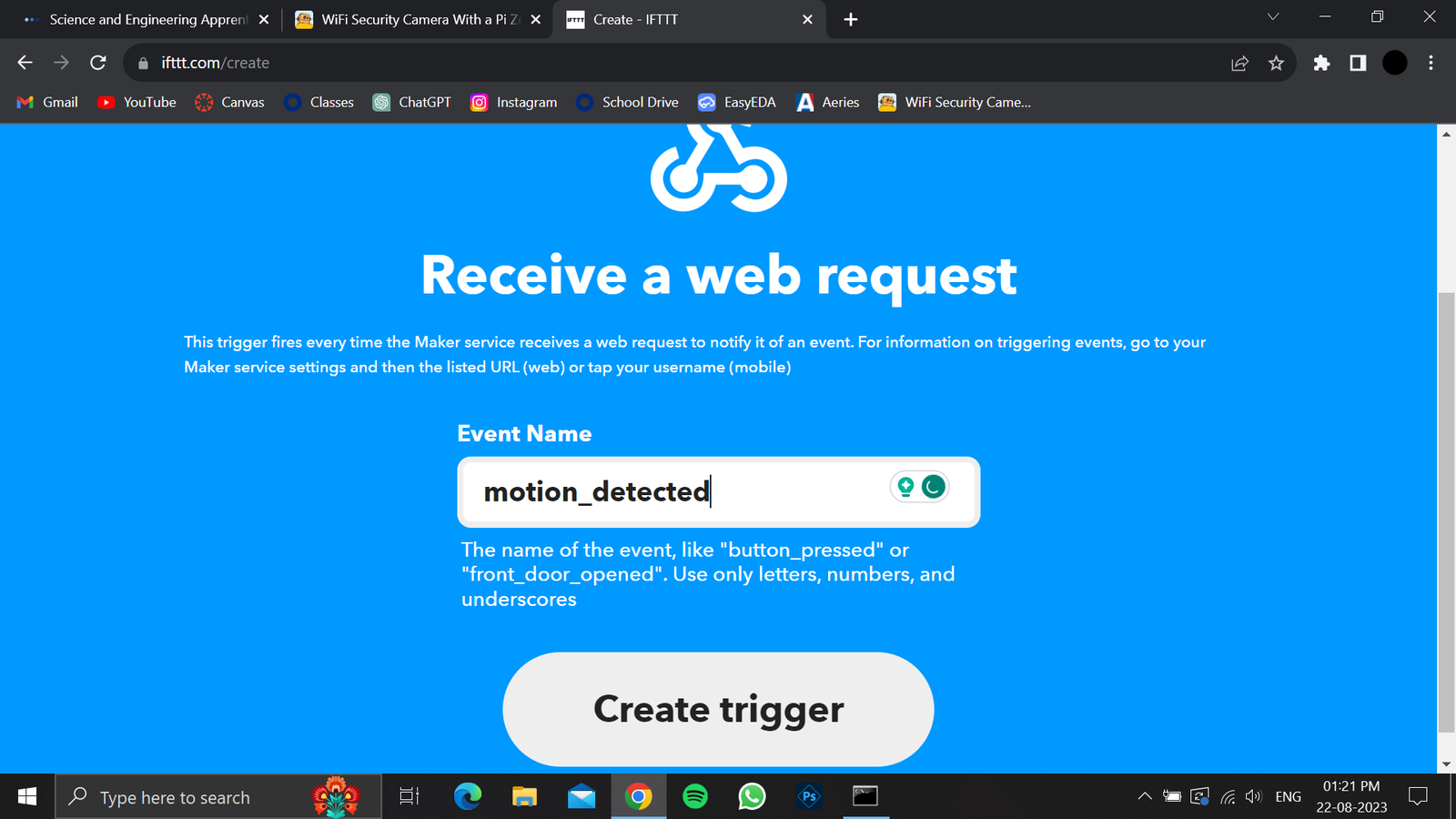

Step 6: Making IFTTT Applets
For this project, we need to make two IFTTT applets: one for sending a text message when motion is detected, and the other for sending a text message when the system is running.
Go to the IFTTT website and sign in with your Google account. Click on the "Create" button at the top. For "If This", search and select "Webhooks". Select the "Receive a web request" option as the trigger. Click on "Connect" at the bottom to connect your account to Webhooks. Type "motion_detected" as the event name and click "Create trigger".
For "Then That", select "Notifications", and click on "Send a notification from the IFTTT App". Set the message to anything you like (mine gives the current date and time) and finish the applet.
Create another applet in the same manner but with 'pi_active' as the event name. For these applets to work, you need to install the IFTTT app on your phone and sign in with the same account you used to create the applets.

Go to the "Explore" tab on the IFTTT website and search for Webhooks. Go to settings in the top right corner and click on documentation. Copy your key at the top of the page.

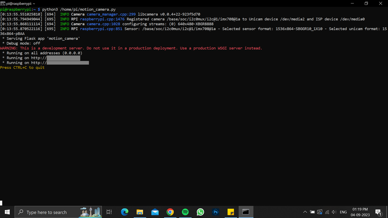

Step 10: The Code
Type 'nano motion_camera.py' to create a Python file. In the editor, paste the code below. THE FULL CODE WITHOUT EXPLANATION IS AT THE END OF THE STEP.

@app.route('/')
def index():
    return "The system is running. For live feed, go to /livefeed"
@app.route('/start')
def startlive():
    t = Thread(target=livedetection)
    t.start()
    return "System started"
@app.route('/stop')
def stoplive():
    global click
    click=1
    return "System stopped"
@app.route('/livefeed')
def live_feed():
    return Response(webframes(), mimetype='multipart/x-mixed-replace; boundary=webframe')
@app.route('/disablemotion')
def disable():
    global motiondetection
    motiondetection=0
    return "Motion detection turned off"
@app.route('/enablemotion')
def enable():
    motiondetection=1
    return "Motion detection turned on"
#Sends a device activated message to let the user know that the program is running.
requests.post('https://maker.ifttt.com/trigger/pi_active/json/with/key/YOUR_IFTTT_KEY')
if __name__ == '__main__':
    app.run(host='0.0.0.0', debug=False) #Runs the web server.

Step 11: First Test
In the terminal, type:
python3 /home/pi/motion_camera.py
to run your script. If there are no errors, you should see something like this on your screen:
If this works, you can close the program using Ctrl+C.

You will receive a notification saying your Pi Zero is active (this is from the IFTTT applet). In any browser on a device connected to the same Wi-Fi network as the Pi Zero, go to 'http://ip_address_of_your_pi/start' and then go to 'http://ip_address_of_your_pi/livefeed'. You should see your security camera in action.
