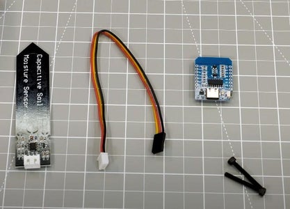

Wemos D1 - https://amzn.to/41WHOL1
Capacitance Soil Sensor - https://amzn.to/41PWMmg
Be sure to get one with good reviews as these sensors are produced very cheaply.
M3x25mm Screws (x2) - https://amzn.to/3oGmOKc
Stainless will perform better given the damp plant environments.
USB Cable & 5V Power Supply - https://amzn.to/3AyrRik

Step 2: Solder the 3 Points From the Sensor
The soil sensor itself will come with a short cable. Cut that in half and then solder the following connections. Be sure to solder the connections as show in the photo above.
Sensor VCC solders to 5V on the Wemos
Sensor GND solders to GND on the Wemos
Signal solders to A0 on the Wemos

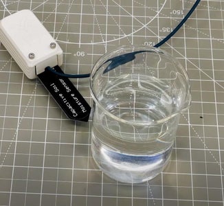

Step 5: Calibrate the Device
You'll need a glass of water to calibrate the device. I suggest watching the video to see how I did it but the process is straightforward.
From your sensor webpage (the same place you went to when you clicked "visit device" in the step above) note the sensor voltage when completely dry. Then copy the HIGHEST value from your measurements and update the "calibrate_linear" part of the code with the voltage that goes to -> 0 Which is completely dry.
Then place only the black part of the sensor into water and then take the voltage readings and update the YAML with the LOWEST value you record.
Once both are updated your device is calibrated and ready for use!
