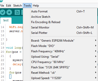

Step 1: Software
For this project, I'll be using Arduino IDE to program and upload the program to the ESP-01, https://www.arduino.cc/en/Main/Software. To get the ESP8266 "board" in the board manager, go to File>Preferences, under settings tab, copy and paste "http://arduino.esp8266.com/stable/package_esp8266com_index.json" into the Additional Boards Manager URLs then go to tools>board>boards manager then key in "ESP8266" into the search and download the result by ESP8266 community. The boards under tools then must be set to "Generic ESP8266 Module" and the rest as shown.
