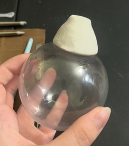

Step 2: Sculpting
  1. The cap of the ornament is removed
  2. The "body" of the characters are hollow and made to fit to the top of the ball
  3. With the correct body proportions set, the detail work of making the heads and arms can be done
  4. Once all the parts are made they are assembled together making the bear and fox
