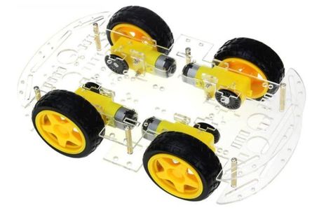

I have built multiple variants of this - including a tank chassis and a "build yourself" model car chassis. The easiest and most fun is to just use the 4 motors and a light piece of wood as a chassis.
  1. Use a piece of wood as a chassis - drill a hole in the centre which will take the wires from the motors
  2. Alternatively use Lego plate as the chassis
  3. Using hot glue, affix the 4 motors to the underside of the chassis and feed the wires from the motors through the hole in the chassis

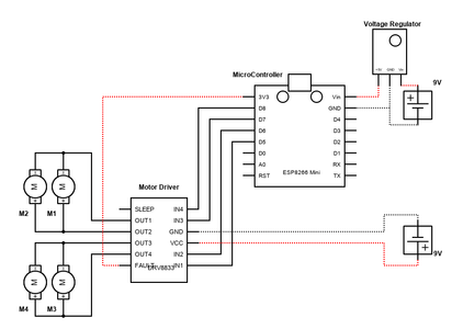

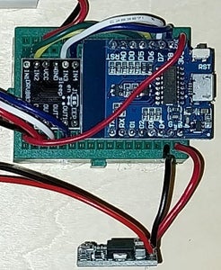

  4. Use a small breadboard - plug in a microcontroller and a DRV8833 motor driver
  5. this is a key reason to use a Mini NodeMCU - it is compact enough to fit on the small breadboard with the motor driver
  6. Connect the wires from the motors to the motor driver - one motor to Out1 and Out2, the other motor to Out3 and Out4.
  7. Connect the microcontroller to the motor driver
  8. D5 to In1, D6 to In2
  9. D7 to in3, D8 to In4
  10. 3v3 to "Fault"
  11. The car needs 2 batteries to be connected
  12. One battery needs the 5V regulated voltage connected to the microcontrollers 5V and GND.(see step 5)
  13. Note that this connection is not needed when the controller is connected to the PC over USB
  14. The other battery (unregulated) can connect to the VCC and GND of the Motor Driver
  15. For both connections, we need to make sure that the + and - are the right way around

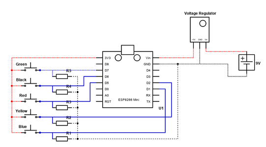

Step 4: Controller Build
I built the controller with 5 buttons - each a different colour. I used different colours to help explain the code logic. Each button is wired with one side directly to the positive rail, the other side to the negative rail through a 10K resistor and then a connector from the button to a pin on the microcontroller:
  1. Green to D7 - this drives Left motor Forward
  2. Black to D6 - this drives Left motor Backward
  3. Red to D5 - this is not currently used - for a future idea
  4. Yellow to D2 - this drives Right motor Backward
  5. Blue to D1 - this drives Right motor Forward
Additionally, we need power to the Microcontroller
  1. A battery with 5V regulated voltage must be connected to the microcontrollers 5V and GND (see step 5)
  2. Note that this connection is not needed when the controller is connected to the PC over USB

Gluing motors to a piece of wood does not look great, you can buy something a little neater. Including
  1. A tank chassis with 2 motors, tank tracks and battery compartment underneath. The wiring and the code is the same as described above
  2. A "screw together" car chassis with 4 motors. There is a 2 motor and 4 motor variant (use the 4 motor) - but wiring and code is the same
