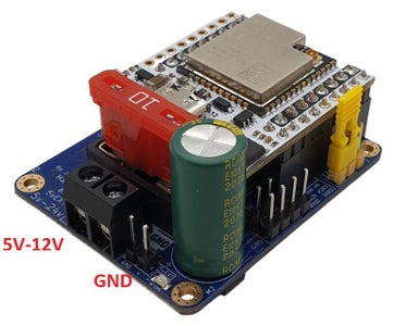

QuinLED-Dig-Uno
This is the heart of the pixel controller. It hosts its own wifi access point or connects to your home wifi network and drives the animated string of pixels. Click here or here to buy them.
Important! The QuinLED-Dig-Uno in your kit comes with a detachable "whip" antenna. This allows your QuinLED-Dig-Uno to have improved wifi range. It has a tiny, brass connector that attaches to the tiny, brass socket on the white board, on top of the QuinLED-Dig-Uno.
We recommend that you do not attach the whip antenna until you get home as the QuinLED-Dig-Uno has an internal antenna that is sufficient for class day. It is easy to damage the plug and/or socket; be very careful when attaching/detaching it!

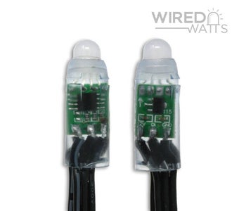

Pixels
There are two voltage types for pixels, 5V and 12V. If your project uses up to 100 pixels, buy 5V pixels. If your project uses 100 or more pixels, buy 12V pixels.
12V WS2811 pixels
These come in strings of 100 or 50 pixels. These are digital lights that are animated with an industry standard protocol called ws2811. Your QuinLED-Dig-Uno, once programmed, will also know this protocol. Pixels come in many shapes & sizes. As long as they support ws2811 or ws2812, they will work with your project. Make sure the pixels operate on 12V DC and that the wire thickness is 20 AWG or lower. This ensures that the pixels can be placed at far distances from your controller. Buy them here.
5V WS2811 pixels
These come in strings of 50 pixels. They are similar to 12V pixels mentioned above. Because they run at a lower voltage, they cannot used for long distances as 12V pixel can. However, using a technique called "power injection", it is possible to obtain longer distances and higher densities of pixels. 5V pixels have an overall lower wattage consumption than 12V pixels. Buy them here.

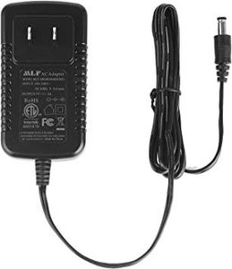

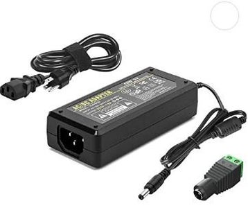

Power supply
ws2811 “bullet” pixels consume up to 0.06A per 12V pixel. Purchase a power supply that supplies 120% of the total number of pixels that your project uses. For example, a 300-pixel project needs 18A, so purchase a 22.5A power supply.
Here are examples of power supplies that would work:
Up to 50 pixels:
AC to DC 5V 4A Power Supply Adapter, Plug 5.5mm x 2.1mm

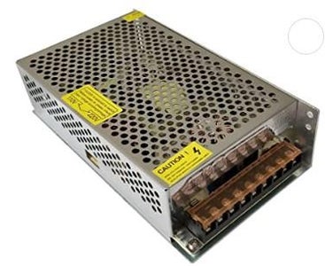

Up to 300 pixels:
Henxlco AC 110V/220V to DC 12V 20A 240W Universal Regulated Switching Power Supply Adapter Transformer Driver Converter for LED Strip Light, Security Camera System, Computer Project
https://www.amazon.com/Henxlco-AC-110V-Regulated-Transformer/dp/B010CVJAYS

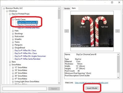

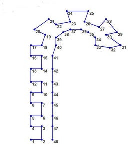

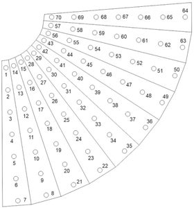

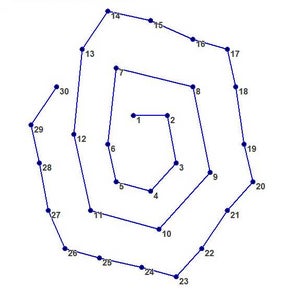

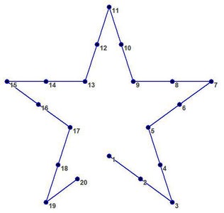

"Coro" plastic shapes
You can arrange your strings of pixels any way that you want (hang them, put them on a tree, etc.). One popular way is to push them into plastic cardboard-like shapes (called "coro").
Here are examples of shapes supported by this Instructable:

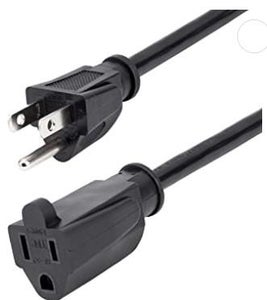

Extension cable
This cord will be used to give your power supply 120 VAC. Any outdoor rated extension cord will work for this project.

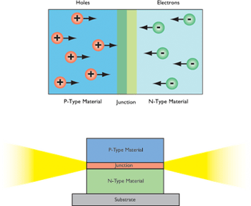

How do they work?
Traditional light bulbs heat a filament to get bright. With LEDs, current pushes negative and positive atoms toward each other, combining to release photons in the middle (light).

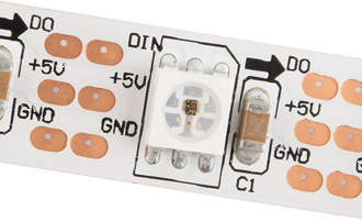

How do pixels work?
Each pixel consists of three LEDs for red, green, and blue with a tiny computer chip to control them. The language (protocol) that the chips use is ws2811.

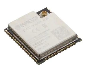

What is ESP32?
ESP32 is a series of low-cost, low-power system on a chip microcontrollers with integrated Wi-Fi and dual-mode Bluetooth. The ESP32 includes built-in antenna switches, RF balun, power amplifier, low-noise receive amplifier, filters, and power-management modules. ESP32 is created and developed by Espressif Systems, a Chinese company, and is a successor to the ESP8266 microcontroller. The heart of the QuinLED-Dig-Uno is an ESP32.

What is QuinLED-Uno?
This is the heart of the pixel controller. The upper (white) board has an ESP32 for its brain. The lower (blue) board has the power circuitry and fuse to connect your pixels to. The QuinLED-Dig-Uno comes out of the box with the WLED software already flashed so it’s really as easy as just hooking up the wires to the screw terminals! It will support pixels from 5V to 24V (the latter are typically used for digital floodlights).

Step 3: Connect Power to QuinLED-Dig-Uno
If your project uses a simple, enclosed DC power supply (sometimes called a “wall wart”):
  1. Cut-off the barrel connector that provides output power. Strip the wires then, twist each set of strands to keep them together.
  2. Use a volt meter to determine which wire is positive and which is ground. Mark the positive wire with masking tape and write “12V” on it.
  3. On the QuinLED-Dig-Uno, locate the two-pin blue terminal near the red fuse. Connect the 12V wire to the “5v-24v +” terminal, then the ground wire to the “GND“ terminal.
STOP: Have an assistant check your work before proceeding further.

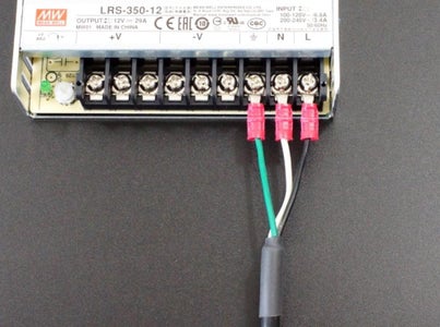

If your project uses a large, rectangular, steel DC power supply:
Important! Do not connect the power supply to AC power until an assistant checks your work below. Otherwise, you may sustain injury from electric shock and/or damage the QuinLED-Dig-Uno.
  1. Cut-off the female end of the AC extension cord.
  2. Strip wires to reveal the black, white, and green wires. Twist the strands on each wire to prevent fraying.
  3. Crimp fork connectors onto these wires.
  4. Attach the black wire to “L” on the power supply, white wire to “N”, and green wire to the ground symbol.
  5. Do NOT plug the extension cord into AC power.
  6. Strip the ends of two 18AWG wires.
  7. Mark both ends on the first wire with masking tape and write “12V” for both ends.
  8. Attach fork connectors to only one end of both wires.
  9. Connect forked end of the 12V wire to the “+” terminal on the power supply (there may be multiple “+” terminals, use any of them.
  10. Connect forked end of the other (non labeled) wire to the “-“ terminal on the power supply.
  11. On the QuinLED-Dig-Uno, locate the two-pin blue terminal near the red fuse. Connect the 12V wire to the “5v-24v +” terminal, then the ground wire to the “GND“ terminal.
STOP: Have an assistant check your work before proceeding.

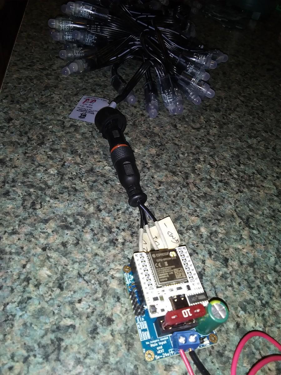

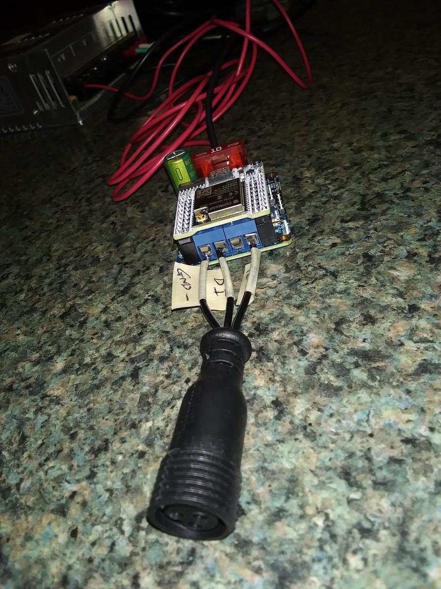

Prepare the QuinLED-Dig-Uno controller
  1. Locate the 4-pin blue connector on the QuinLED-Dig-Uno. It is closest to the silver square on top of the board.
  2. To access the screw terminals on this blue connector, gently pry-off the white board on top of the controller.

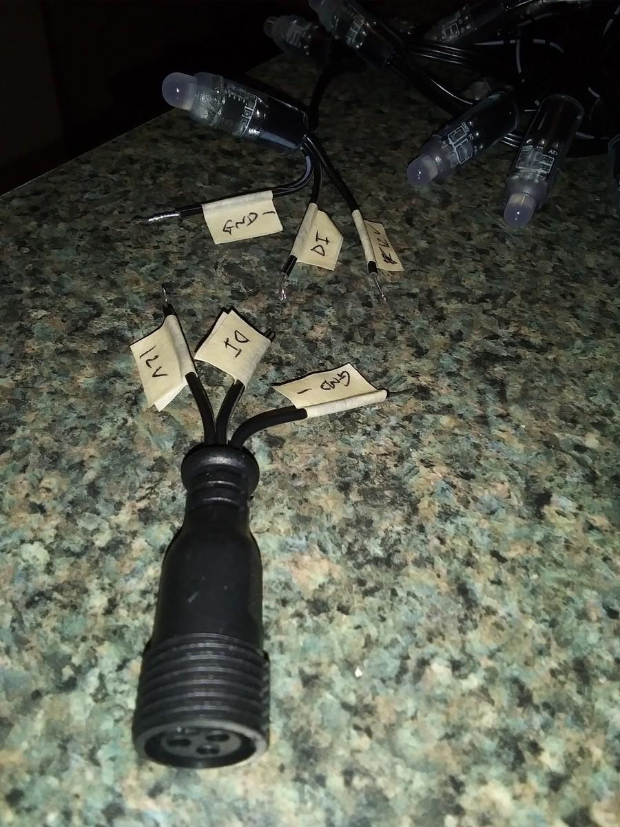

IMPORTANT: On both ends of the string, you will notice extra pairs of blue & red wires, already stripped. Snip off the bare wires! Otherwise they may touch while powering the string, shorting them out and causing damage.
  1. The pixels in your string use three wires: data, power, and ground.
  2. Each string has an “input” end and an “output” end.
  3. Each pixel in that string has an "input" side and an "output" side.
  4. With the 5V strings, the input end has a flat, female connector. The output end of the string has a male connector.
  5. On each pixel, its input side has “+5V, DI, and GND” marked on its circuit board. The output/opposite side on each pixel has no writing on the circuit board.
  6. Cut-off the output end of the string (male connector), leaving spare wire after the last pixel (and leave spare wire on the male connector, too).
  7. Strip the wires on the male connector, then twist the strands on each wire to prevent fraying.
  8. Under the blue 4-pin terminal, you will see them marked “+”, “LED2”, “LED1” and “-“.
  9. Connect the male connector’s red wire to “+”
  10. Connect the white wire to “LED1”
  11. Connect the blue wire to “-“
  12. Carefully reattach the white board to the top of the controller. The USB connector faces the red fuse.

  9. On the female connector at the end of the the third string (string "3")…
  10. Because all three wires are the same color, mark each wire twice. For the 12V wire, put one label close to the pixel and the other close to the female connector. Repeat for the GND and DI wires. You should have six labels altogether (two 12V labels, two DI labels, and two “GND” labels.
  11. Cut-off the output end of the string (female connector), leaving spare wire after the pixel (and spare wire on the female connector, too).
  12. Strip the wires on the female connector, then twist the strands on each wire to prevent fraying.

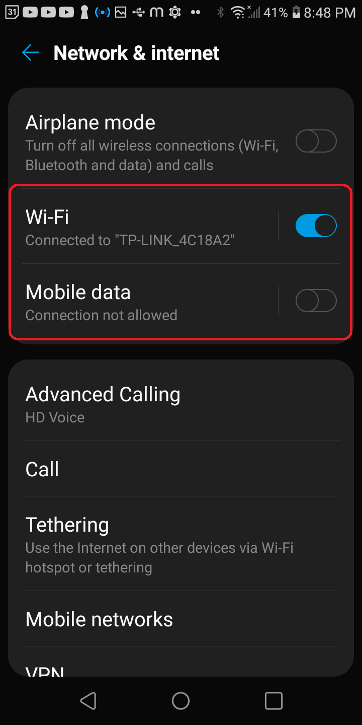

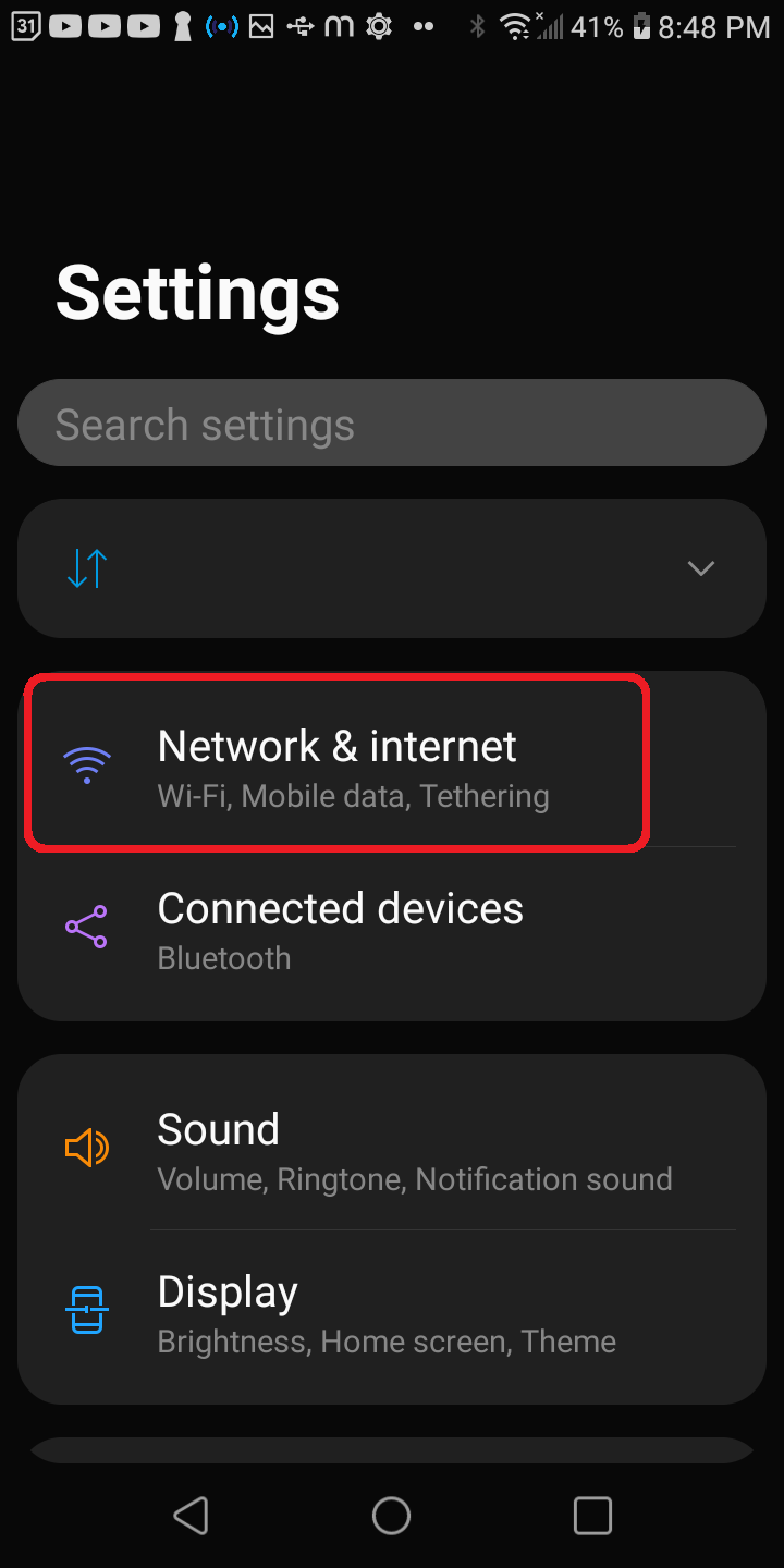

  3. On your phone…
  4. Disable Mobile Data
  5. In Android, go to Settings > Network & Internet > Mobile data
  6. View wireless networks
  7. In Android, go to Settings > Network & Internet > Wi-Fi

The “brain” of your device is an ESP32, a microcontroller similar to an Arduino. As with Arduino, the ESP32 has data output pins, two of which are reserved for each of the two strings. We need to set the correct data pin on the QuinLED-Dig-Uno that represents the terminal marked “LED1” on your QuinLED-Dig-Uno.

Step 10: Mark Pixel Order on Shapes
When inserting pixels into your coro shapes, you have to insert them into a particular order. This way, xLights knows exactly where the pixels are. Then, when you create animations in xLights, the animations will appear on the coro shapes as shown on the screen.
With the 5V pixels for this class (red, white & blue wires), the first pixel starts after the flat female connector.
With the 12V pixels for this class (black wires), the first pixel starts after the round male connector.
The included wiring diagrams will provide the order for each pixel. Here is how to use them:
  1. Determine the front of your coro shape.
  2. Flip the shape over to its back side. The wiring diagram is meant for the back of your coro shape.
  3. With a Sharpie ultra-fine marker or ball-point pen, mark each hole on the coro shape as indicated by the wiring diagram.
  4. Insert the pixels in the order of the numbers.
  5. The pixels have 3" spacing between them. In some cases, the distance between two holes may be greater then 3", so the next pixel can't reach the next hole. If that happens, you must cut the string and solder extension wires (three of them, one each for power, data, and ground) between the pixels that need the longer reach.
  6. IMPORTANT: Be sure not to mix-up the power, ground, and data when joining the pixels back together with the extension wires! Remember to look at the markings on the pixels to determine which is power, ground, and data for each pixel.
Note that the matrix coro shape can be wired four different ways, if desired. The starting pixel can start in any of the four corners, though the remaining pixels must be inserted horizontally, one line at a time. Refer to the included wiring diagrams and do not deviate from them.

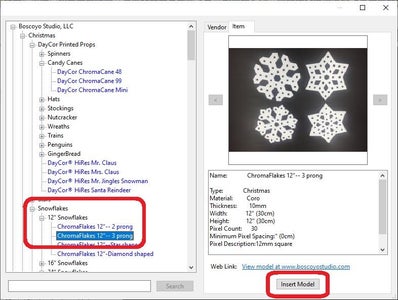

Step 14: If You Have a Custom Coro Shape (ex. Snowflake, Candy Cane) and Not the 3D Tree
  1. Connect your laptop to wifi with Internet, such as wifi at the class' makerspace or your home wifi.
  2. Click the Layout tab at the top.
  3. In the lower-left part of the window, disable "3D" (remove the checkmark).
  4. IMPORTANT: Follow the below steps very carefully.
  5. Above the big black box is a list of models (arches, candy canes, etc.). Click the "down arrow" icon at the end of this list
  6. "Create new download" will appear when you touch it with the mouse.
  7. Point to the big black box, then hold down the mouse button to drag the outline of a rectangle. It will appear somewhat invisible (no outline) with blue corners as you drag it larger.
  8. When you release the mouse button, a window appears with a large list of coro shapes
  9. To find the snowflake shape, open the "Christmas > Snowflakes > 12" Snowflakes" sections, then choose "ChromaFlakes 12" -- 3 prong".
  10. To find the candy cane shape, open the "Christmas > DayCor Printed Props > Candy Canes" sections, then choose "DayCor ChromaCane 48".
  11. Choose [Insert Model] at the bottom-right of the window.
  12. A "dotty" image of your shape will appear in the black area.
  13. If the dotty shape looks out of proportion (a "fat" candy can, for instance), you can drag the blue corner handles to reshape it.
  14. On the left side of the screen, we need to associate the shape with your QuinLED-Dig-Uno controller. In the table in the lower-left area of the screen, specify:
  15. Name: CandyCane or Snowflake (no spaces)
  16. # Strings: 1
  17. Controller: Use Start Channel
  18. Start Channel: 1
  19. Click the red [Save] button at the bottom.
  20. Connect your laptop's wifi to the QuinLED-Dig-Uno. That way, xLights on your laptop can "see" it and send animations to it.
Now xLights knows about your coro shape!
Step 15: If You Have the 3D Tree Coro Shape
Your 3D tree has two shapes: the tree's body and the tree's star. We need to create each of these shapes (called "models" in xLights) separately. Here is how to do it:
  1. Click the Layout tab at the top.
  2. In the lower-left part of the window, disable "3D" (remove the checkmark).
  3. IMPORTANT: Follow the below steps very carefully.
  4. To make the tree's body
  5. Above the big black box is a list of models (arches, candy canes, etc.). Click the "tree" icon near the end of this list
  6. "Create new tree" will appear when you touch it with the mouse.
  7. Point to the big black box, then hold down the mouse button to drag the outline of a tree.
  8. IMPORTANT: Click the [Create new tree] button three times (slowly) to stop the drawing process.
  9. Click the tree. The white dots will turn yellow.
  10. On the left side of the screen, we need to associate the shape with your QuinLED-Dig-Uno controller. In the table in the lower-left area of the screen, specify:
  11. Name: Tree
  12. # Strings: 1
  13. Nodes/String: 70
  14. Strands/String: 10
  15. Starting Location: Top left
  16. Controller: Use Start Channel
  17. Start Channel: 1
  18. Click the red [Save] button at the bottom.

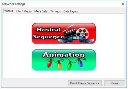

  1. Click File > New Sequence from the menu.
  2. On the "Sequence Settings" screen, choose the green [Animation] button.
  3. On the next screen, choose the green [20fps] button.
  4. On the next screen, click the [Done] button at the bottom.
