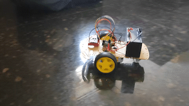

Step 1: Assemble Your Robot
Once you have your materials, it's time to assemble your robot. You can use any type of chassis, such as a 3D-printed one or the one shown above, as long as it fits your motors and battery pack. Connect the motors to the motor controller, and connect the motor controller to the ESP8266 using jumper wires as shown in the circuit diagram. Then, connect the battery pack to the motor controller and the ESP8266. Finally, mount the ESP8266 NodeMCU on the chassis.
The ESP8266 NodeMCU can take 12V input from the battery directly. It also gives 5V output which can be used for motor driver. Make sure that all the ground connections are connected to the battery ground terminal.

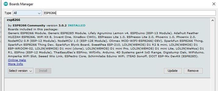

Step 3: Arduino IDE
Install Arduino IDE from the official Arduino website and follow the instructions. Open the Arduino IDE and install the board package for ESP8266. To install, Go to Tools --> Boards -->Board Manager and type ESP8266 and install the board package.
Once board is selected, select the COM port on which ESP8266 is connected, and write the following code.
