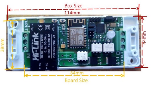

The size of the board is 84mmX39mm and with box size 114 mmX44mm, as shown in diagram1, it has a capacity to drive upto 1 Amp load. The board has a Wifi module(Esp 12F) and microcontroller (atmega328p) same as that used in Arduino Uno , which is used to control the triac through HTTP or MQTT mode . The board has two DC virtual switches which can be used to control the two Triacs.
The board also has a Power module (AC to DC converter) capable of handling 100-240 VAC as input and gives an output of 5V 0.6A. There are two triac( BT136) and Terminal connector. There is Zero cross detection also available which is used for dimmig. There are two triac used one for dimming and another for on /off purpose.

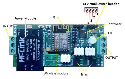

The diagram2 gives the details of the headers and terminal blocks.
To board 230VAC is applied to the input terminal block and load is applied to the output terminal block.
On the board J3 header is used for the dc virtual switch the header details can be referred form the diagram4. First pin is vcc-3.3v, second pin is atmega328p gpio pin for arduino programming we need to use A4 (ON&OFF), third pin is atmega gpio pin for arduino programming we need to use A5(DIMMING) and fourth pin is ground. For dc virtual switch we are using only second and third pin i.e A4, A5 and Fourth pin i.e ground, this is mentioned in the diagram3 for connection of virtual switch.
