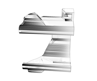

Step 1: Collecting Parts and 3D-Print (1)
Before we start assembling the accessory, we need all the parts. The body of the accessory is a 3D printed piece, the STL-file can be found in the attachments. The rest of the parts are grommets, rings to connect with the plate, a stiff, wide elastic, a long elastic robe, and a nail.
The holes in our model are made for nails with a maximum diameter of 3,5 mm. If you want to use a bigger nail, remember to change the holes in the model accordingly.
Cut the nail into two pieces of 28 mm (also depending on the model you use).
