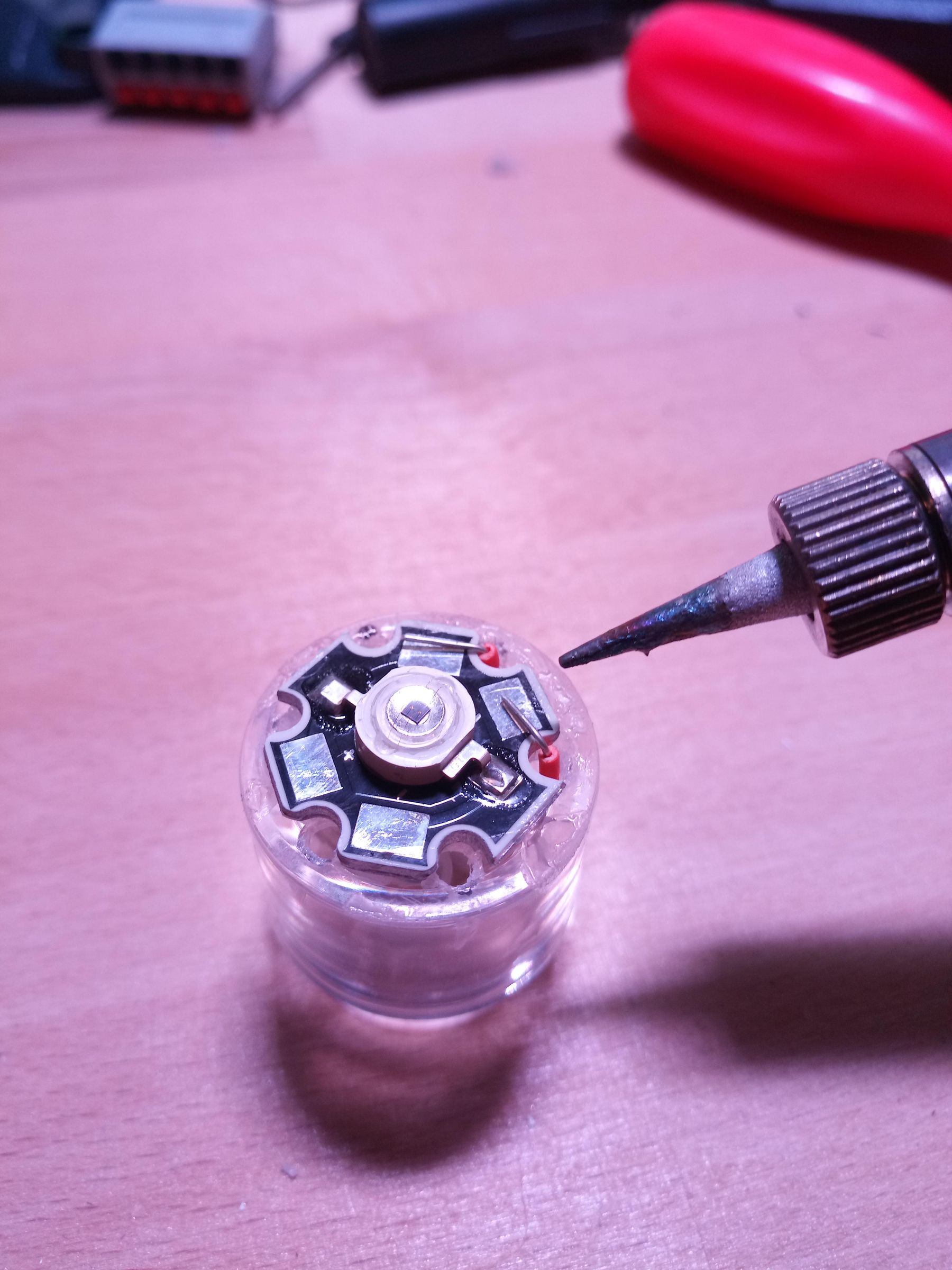

Step 2: Build 2 IR LEDs or Mount Sensor Bar
You can build two IR LEDs your own or use the Wii Sensor bar. It is only important that the LEDs are aligned horizontally with the monitor. In normal cases Mayflash Dolphinbar is not working, but common usb wii bars or the original wii bar. (Update: Seems like LightGunMan on YouTube found a solution to use Mayflash Dolphinbar. Added Info about this at the end of the Tutorial. Step 15)

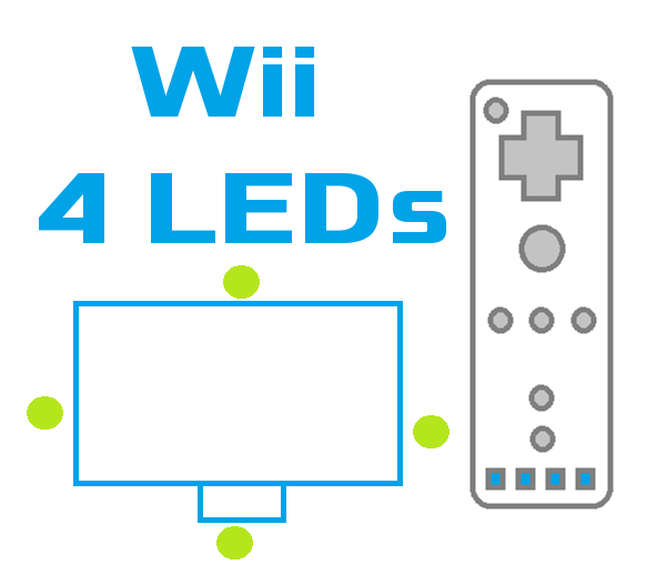

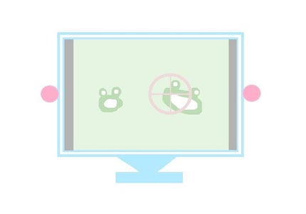

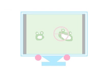

If you build your own infrared LEDs, they can be attached to the monitor in many different configurations. Look at the pictures as examples.
As you can see, the LEDs can actually be placed however you want, as long as they are aligned horizontally. This also means that the Wii Sensor Bar can be on top of the monitor or underneath it.
The LEDs do not necessarily have to be centred on the monitor. Never move the LEDs after calibrating, else the calibration will become invalid.
If you build your own infrared LEDs you can watch the video, which is actually for the 4 IR LED Tracker. However, the same principle can also be applied to the 2 LED Tracker. Use the LED configurator shown in the video. But there are far much more easy solutions on youtube with for example USB+LEDs. But beware you need Infrared LEDs.
Since version 0.9.8 you can use the BAD-LED mode for low powered IR-LEDs also. This steals an almost not noticeable/configurable amount of frames for interpolation.

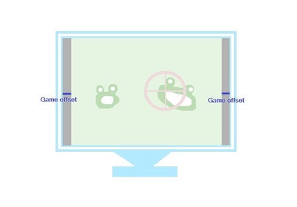

Step 7: Game-Offset Calibration
Sometimes the games are not fully scaled over the whole surface of the screen and have an edge. In this case, you can use the LED Offset configuration to adapt to this circumstance. We refer to this configuration as the LED gaming offset.
You can set the values individually for all LEDs. Top, bottom, left and right. (Look Screenshot)
To calculate the values, take a look at the following tutorial:
https://geekonarium.de/en/what-is-ir-offset-and-wh...
The IR LED offset is only relevant for the 4 LED tracking system. For the 2 LED tracking system IR-Offset is already a part of normal calibration.
