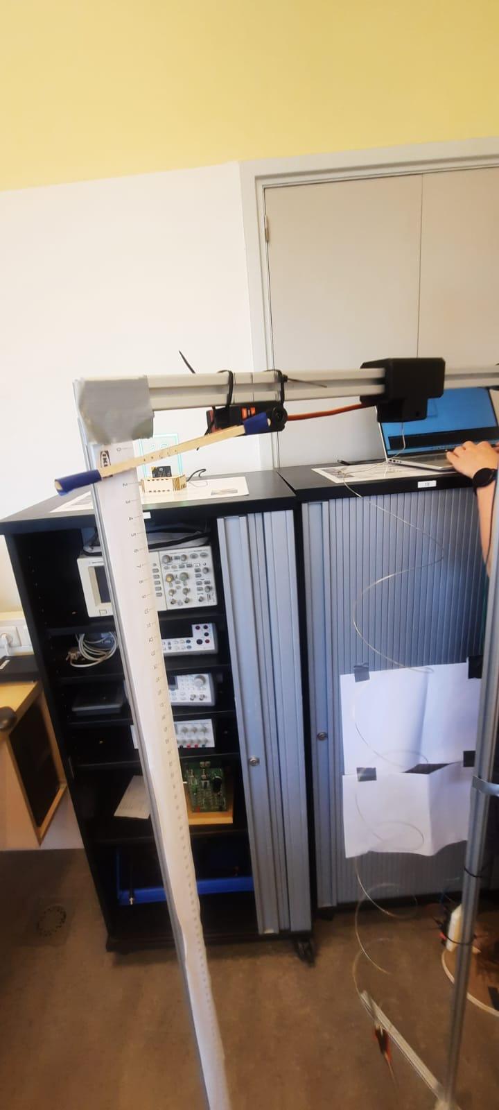

A Wilberforce pendulum isn't a complex thing to make and does not need to be overcomplicated. First thing we thought about was to make the stand for the pendulum. We made a rectangle using ITEM profiles, where you have two vertical profiles connected to eachother by a profile at the top and bottom. For stability at the bottom we gave the two vertical profiles footing. This was done by attaching the profiles perpendicular to the vertical ones.

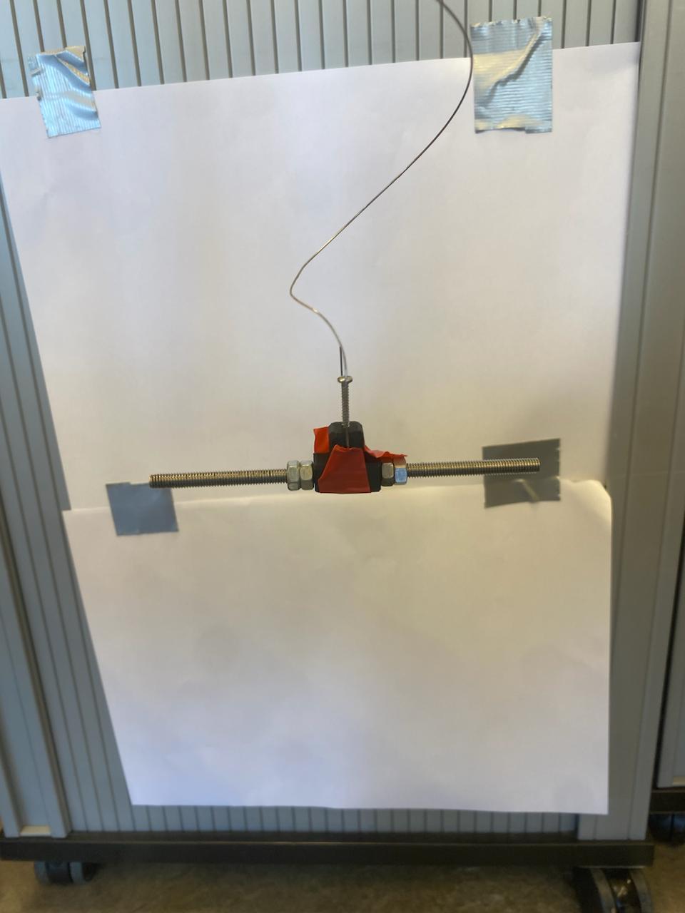

The spring would then be attached to the top of the stand, using a 3D-printed piece. For the object at the bottom; it consists of a screw where we will tweak the inertia using nuts. Again, to attach spring and the object we use a 3D-printed tool.
The spring was made using a spring winder (can also be done with a turning lathe).
For style points, we also tracked the motion of the spring using OpenCV and python. We connected a webcam to our laptop, and put the webcam on a stand. This stand was made of wood (rectangle shape and a footing at the bottom attached via screws and wood glue). The height of the webcam can be adjusted simply by taping it on a point on the wood piece.
(For even more style points), we added a servo-motor to the top to give it an extra kick when it oscillations start to slow down.
P.S: For live-tracking use a white background with good lighting.
Step 2: The Spring
Time for some handywork. You could purchase a spring, but because that can be risky (and boring) it is better to wind your own. For this spring, stainless steel was used. Our spring is roughly 20 cm in length and 7 cm in diameter but you could make a different one to suit your needs. Changing the length has no effect on After the spring has been wound, bend a hook at each end. The 3d printed pieces will come there later.
We wound our spring with the contraction depicted above. By putting one end in the central tube you can bend the steel in a coil like shape. Once you are happy with the amount of winds you can cut off the end. Aside from this contraption, there are a lot of other ways to make a spring, such as a lathe or other similar contraptions.
Once your spring is finished, it is important that you find out it's spring constant (k). This can be done in a multitude of ways. The easiest way is to hand a couple of different known weights from the spring and measure how long it stretches. From there you can make a graph and calculate the spring constant.

Step 4: Do the Math
To make the pendulum work, the frequency of the spring, in the vertical direction, must match the rotational frequency. The derived formulas for the frequencies are ω_spr = √(k/m) and ω_rot = √(c/I), with k and c the spring- and torsion constants, respectively. You have minimal influence on these two, so to get them to match, you can twist the values of I and m. The formula for the inertia is I = ∫r^2 dm. To calculate the total inertia you can use the sum of the smaller parts, so the inertia for the shaft and the nuts and the bolts.
We must say that there will probably be a difference between what you calculate and what works best, as is always the case with these experiments. You have to try a couple of different setups and iterate until you are satisfied with the working.

Step 7: Servo-Motor
To make sure the spring keeps oscillating and doesn't eventually stop, we added a servo-motor at the top of the stand. It is connected to an arduino board and a bread board. The arduino board is connected with a battery. We used zipties and tape to attach it to the stand. We used coffee sticks to attach (with tape) to the servo motor for a longer arm.
