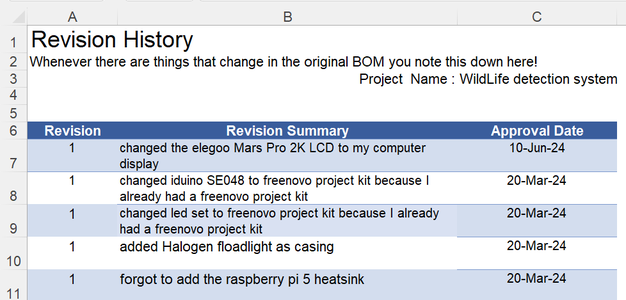

For Supplies and cost (at time of making this) see attached files.

For this you will need to get a casing (for waterproofnes) I used an Halogen floadlight.
A PIR sensor was used for power consumption reduction.
A battery so that you can power everything and place it in the wild.
