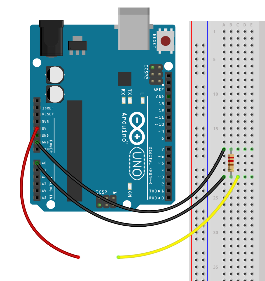

Step 2: Wire the Leads
Use the Arduino, breadboard, jumper wires, and sensor to match the wiring diagram:

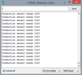

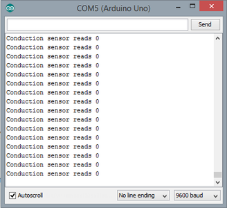

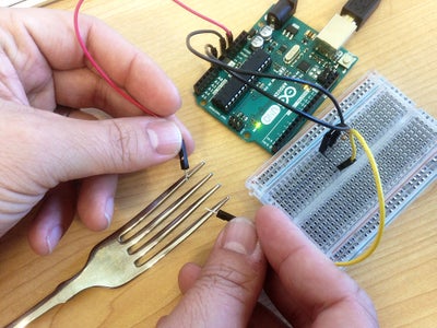

Gather your items. Take one and touch the yellow lead to the surface of your item. Take the red lead and also touch the surface of the item (be careful not to accidentally touch the two leads together.) Make note of the number from the serial monitor and then move on to doing the same thing for each item in your group.
Once you've tested all of the materials, find which one has the highest number.
Congratulations! You've found the life saving materials.
