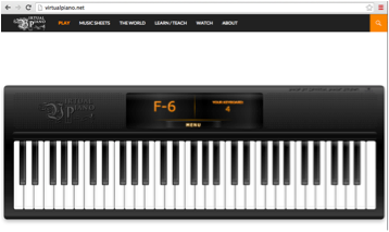

Makey-Makey has a simple piano app, but it only uses the first 6 notes CDEFGA. You cannot play a B on the Makey-Makey piano. If you need to play a B, try another piano app like Virtual Piano.
