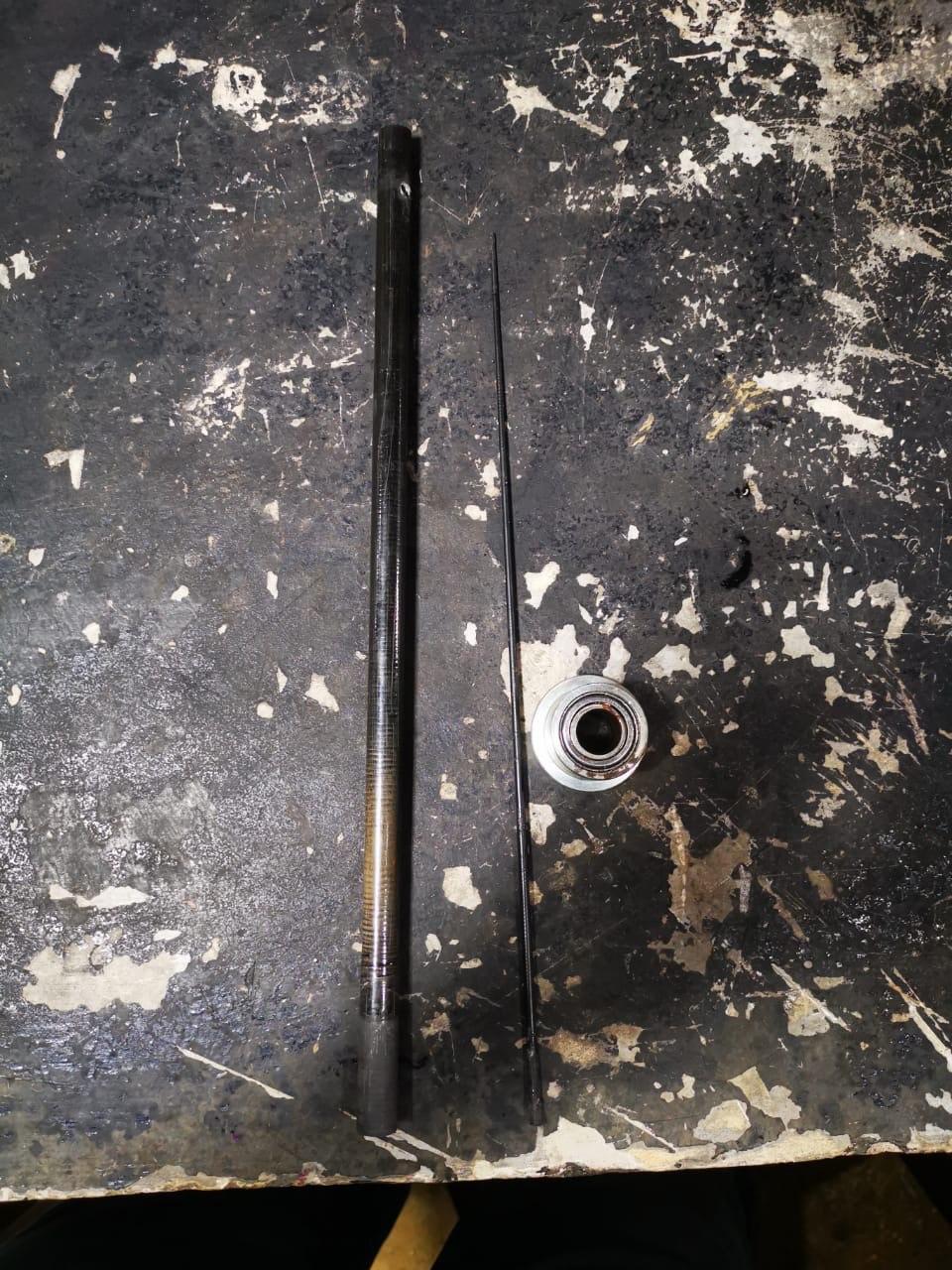

  • Arrow carbon
  • Container
  • Drill
  • Hot glue gun
  • Tape
  • Computer

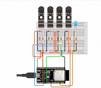

Step 1: Design and Set Up the Circuit
The image used in this report is very brief but revealing regarding the specifics of circuit design, and it provides an accurate 2D representation. This visual presentation acts as a starting point in understanding the schematic map and also how various components are related to each other.

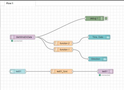

Step 4: Create a Dashboard Using NodeRed
Wind Direction Dashboard Setup:
1. Open Node-RED.
2. In the palette, select "dashboard."
3. Add the MQTT node to the workspace.
4. Double-click the node to edit its properties.
5. Create a new MQTT broker setup by clicking the pencil icon.
6. Enter "broker.hivemq.com:1883" in the server field.
7. Click "add" to confirm adding the MQTT broker.
9. Name the node "GetWindDirData."
10. Leave other configurations as default.
11. Click the "Done" button to confirm the MQTT node properties configuration.
12. Add a debug node to the workspace and connect it to the MQTT node.
13. Add a function node named "function1" to the workspace.
14. Add a text node from the output UI for the dashboard, name it for time and date, and connect it to the "function1" node.
15. Add another function node named "function2" to the workspace.
16. Add a text node from the output UI for the dashboard, name it for wind direction data, and connect it to the "function2" node.
17. Connect both function nodes to the MQTT node.
18. Click the deploy button to redeploy the flow.
19. Observe the incoming JSON payload on Node-RED's debug sidebar from the MQTT topic published by ESP32, with a time interval of 5 seconds.
Led Setup:
1. Add a switch node to the workspace and name it "led01."
2. Add a function node connected to the switch node, and name it "led01_func."
3. Add an MQTT node connected to the function node, and name it "led01."
4. Click the deploy button to redeploy the flow.
5. Observe the incoming JSON payload on Node-RED's debug sidebar from the MQTT topic published by ESP32, with a time interval of 5 seconds.

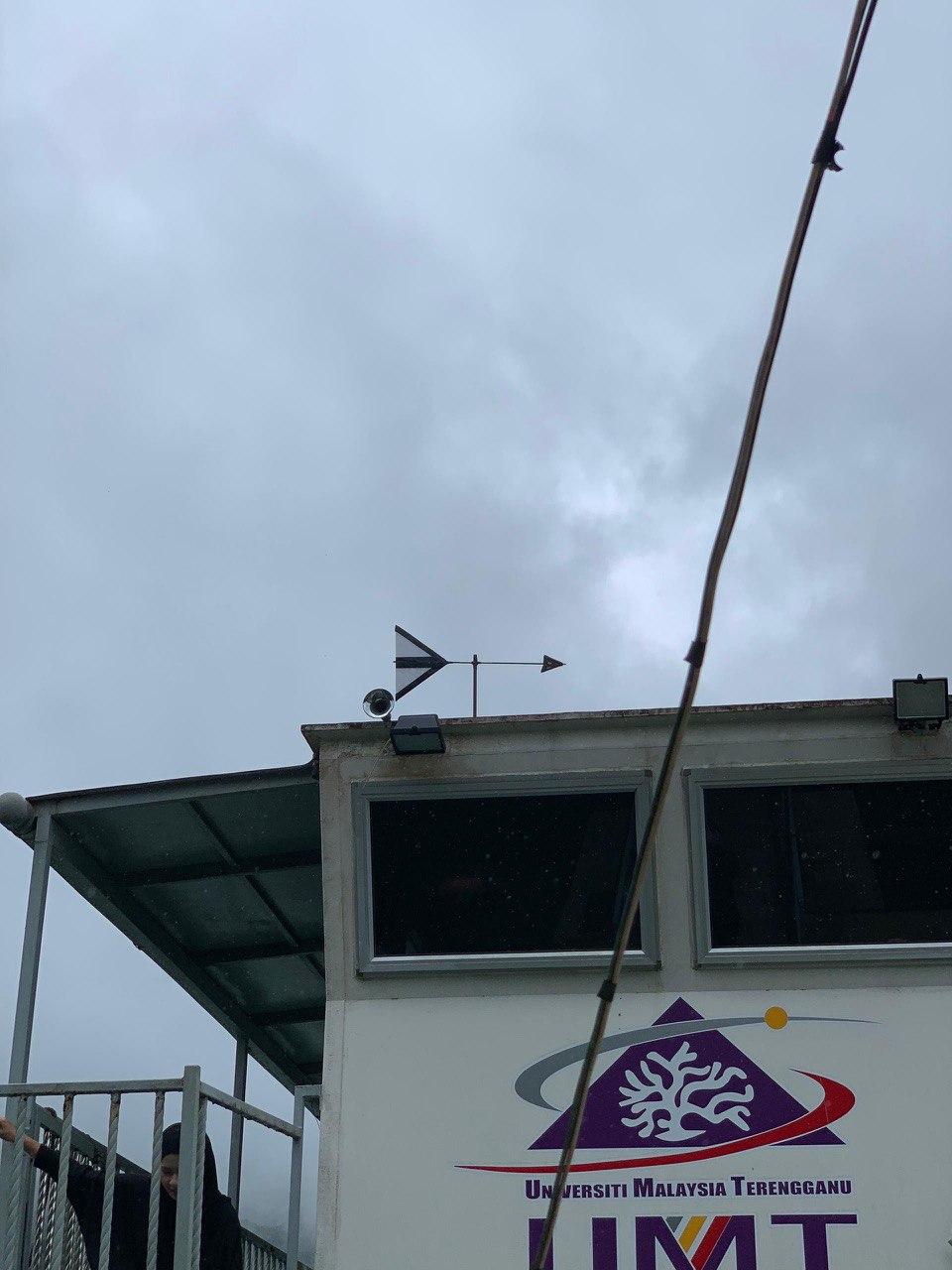

Step 6: Implement and Deploy
  1. The image above depicts the process of deploying the system in its environment.
  2. Place the assembled circuit in a transparent container to ensure waterproofing when deploying.
  3. Secure all the wires with a glue gun to keep them in place.
  4. Seal the transparent container with tape to secure and prevent water from entering.
  5. Find a suitable location to deploy the sensor. The sensor should be positioned at a high place for accurate wind measurements.
  6. The north sensor need to be manually position toward real north in order to make it works.
  7. For this project, we chose to deploy the sensor on top of the houseboat roof.
  8. The sensor receives power through a USB cable connected to a power socket in the houseboat.
  9. Make sure to secure the sensor and ensure it doesn't move.
