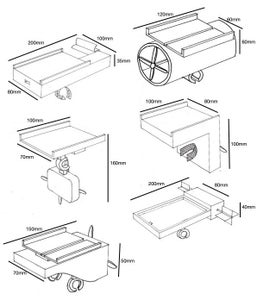

Step 1: Ideation and Development
In the ideation stage, I tried to keep in mind the following essential considerations to reach a suitable design:
Function: Should provide maximum power output at a constant 5V, and should be adjustable to fit a range of phone sizes (60x130mm to 90x170mm) and handlebar sizes (22-32mm diameter). Clipping the design onto handlebars should be fast (take no longer than 5 seconds)
Size: Entire phone screen and all side buttons should be accessible, with propellors not interfering with handlebars or brakes
Shape and form: Should be aerodynamic with curved edges where possible, possible to 3D print
Joining: Should only use nonpermanent joints, as these allow the design to be easily disassembled and separated, allowing for easier repairs and recycling
After some initial sketches, I decided to go forward with a design using 2 sideways propellors, which would help generate more power, with the turbines spinning easily due to the wind always being in the same direction (straight towards the bicycle).
Creating a low fidelity cardboard model allowed me to test the design on a real bicycle with a phone, helping me make some necessary improvements leading up to the final design.
