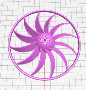

1: Propeller, Size:125(dia) x 17.6(H) mm, Weight: 32g

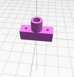

2: Swing Support, Size:10(W) x 20(H) x 30(L) mm, Weight: 3g

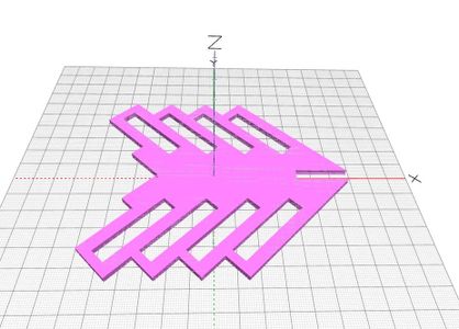

3: Vanetail: Size: 128.6 x 113.1 x 3(H) mm, Weight: 25g

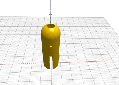

4: Vane Clamp: Size: 16(dia) x 47.4(H) mm, Weight: 9g

Prepare the propeller.
Open the hole with a 3.5mm drill bit.
Cut a 12mm length of 3.5mm brass tubing, smooth the inner and outer edges with a file/sanding paper.
Insert into the tube a flat headed nail or screw and using a vice or G clamp press the tube into the centre of the propeller until fully inserted.
Prepare the metal tube for the propeller.
If necessary with a reamer or 5mm drill bit open out the end on the tube to accept the standoff.
Apply a suitable adhesive or epoxy putty into the end of the tube and push in the standoff.until its flush with the end and set aside to cure.
Prepare the vane tail.
Apply a little adhesive to the edges of the vane tail to which the vane clamp will be attached.
Push the vane clamp onto the vane tail, if necessary insert the metal tube unto the hole in the tail clamp to retain alignment. Be aware of applying too much adhesive if you wish to remove the tube at a later time.
Set the vane tail assembly aside until the adhesive has cured.
Prepare the swing support.
Open the holes in the swing support with a 2mm drill bit
Align the 2 x M3 x 6mm in the holes in the swing support and with firm pressure screw them into the holes ensuring they sit straight in the holes.
