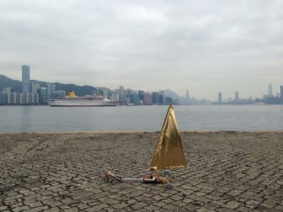

The aim of this prototype was to develop a wind train from our last model - the Windtrain Protei Land Yacht. And that would have both improved performance and construction compare to the last model we had. We were more interested in making a single module that functioned well on its own than a long windtrain first. This model is essential to our next WindTrain development as much of the problems in the last model has been solved.

The design we choose for was to have a smaller central platform. There will be a cavity that would act as the foundations of the mast, as well as the platform for electronics.
The collapsable element was the mast, it would be made up of a telescopic section that could slot on top of a section that was attached to the base frame. The lower section would be mounted to a pivot, but this time we will add the platform for universal camera mount which fix the position of mast.

The problem of the WindTrain is that we do not have a adjustable outhaul system. In the previous version, we used a servo to control the sail tension but it turns out that this way is not effective enough to control and too sensitive for any small change in wind direction and speed. Meanwhile, it does put more weight onto the WindTrain.
This time we use the elastic string to solve the problem. The more the wind blowing to the sail, the larger the angle of boom deviated from the central line. The larger the angle, the stronger the tension the elastic string to pull the sail back to central line. Theoretically, it works. However, in reality, the tension the string exerted depends very much on the setting up, which means the length between 2 knots. If the kids tie it too tight, the WindTrain would have problem travelling downwind while it would not be able to travel upwind if the string is too loose to produce pressure difference on its two sides. It would be very nice if we can have a adjustable outhaul system and at the same time have less weight carried on it.
