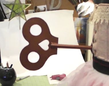

Step 4: Make the Key
Draw your key out on a piece of foam core board. I traced around a glass to start making the shape of the key and then just free-handed the rest of it. At the bottom, don't forget to add a notch that's wide enough to accommodate your dowel and about 3/4 inch tall.
Glue the dowel onto the key.
Paint your key! I painted mine with an undercoat of black followed by some copper craft paint. If you're using foam core, don't use spray paint. The chemicals in spray paint eat away at the foam and that's no good.
Step 5: Glue the Key
Hot glue the wind up key onto the shaft of the wind up mechanism. Try not to overfill the key (like I did) because the glue will squeeze out and get on the belt, gluing the key to the belt, rendering it useless.
If you do happen to do this you can just carefully snip around the base of the key to try to separate the key from the belt.
