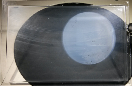

One of the major pain points to using both SLA and DLP printers is that the optical transmission of the PDMS windows change over time. This "clouding" or "fogging" is very clear to the naked eye, as the two photos of a used windows beside a new one show. There are two causes for the clouding. First, the UV absorbing species in the resin soak into the PDMS decreasing its transmission over time. In some resins this appears as a pale white glow over the whole window due to the fluorescence of the UV blocker. This is particularly obvious in the lower angle left photo. In resins like Autodesk Standard Clear, the uptake of resins by the PDMS is small, and the amount of UV blocker absorbed it even smaller. However, this small amount is still sufficient to greatly reduce the optical transmission. This process takes weeks and ultimately reduces the transmission from 90% to ~ 65% even when they are not used for printing.
The second mechanism occurs only in areas used for printing. In this case the surface becomes rough and scatters light. If the same print is performed over and over a very clear image will form on the PDMS. In the photos above this is the more opaque clouding in the upper right of the window.

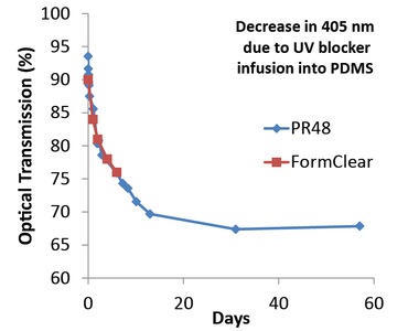

When PDMS windows are soaked in resin they absorb a small amount of the resin. While this amount is small, 0.7 % wt./w.t for Autodesk Standard clear, the photoinitiator(s) and UV blockers present in the resin can also be taken up by the window. Because these species strongly absorb light, the optical transmission of the window is reduced. This process is not fast, and it requires about a month for the window to reach equilibrium.

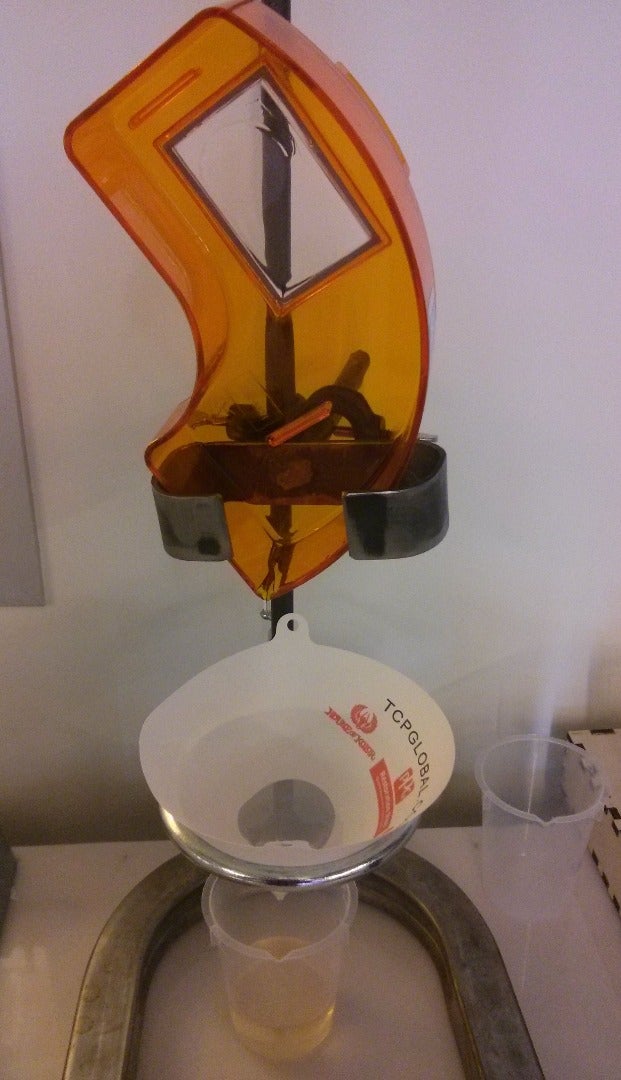

After I terminated the cylinder print, I would then print the posts.stl and record the number or posts printed. The tray was then drained and carefully cleaned using an acetone wetted wipe used to remove the final traces of resin. Unfortunately the Kim-wipes I used scratched the surface. This reduced the light transmission on the unprinted side of the window compared to the window that was just soaked in resin. I would strongly recommend using microfiber cloths for cleaning. After cleaning a UV-Vis measurement and a quick snap shot was then recorded.

Despite the low quality of the photos a gradual increase in opacity and heterogenatity of the window can be inferred. At 30K layers several types of damage are apparent to the naked eye.
1) A general white haze in the printed area which began appearing at ~ 5K layers.
2) More opaque regions throughout the printed areas, which area to be more frequently encountered in areas further from the drive shaft. These began to appear somewhere around 7-10 K layers
3) Areas where large (~1 mm ) chunks of PDMS have been removed from the surface. I believe this is what finally "killed" the ability of the window to print without jamming. When these appeared at 24 K layers the 30 mm cylinder stopped printing. When they appeared at 30 K layers with the smaller solid the printing again became nearly impossible. Again, this damage appear at the furthers points of the print from the point of rotation. These are also the areas that experience the greatest force from the separation process.
4) Scratches from the print being rotated over the PDMS. Somewhat surprisingly these do not appear to correspond to the highly damaged areas, and are perhaps due to a marred surface on the build head.
5) Scratches from cleaning out side these regions.

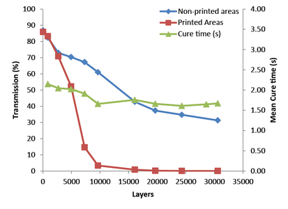

The UV-Vis confirms the rapid increase in opacity that is visually observed in the areas used for printing. This approach is much more sensitive that visual observations, as the the transmission decreases from 85 % to less than 5% by 10 K layer; however, this sensitivity also eliminates any insight to changes past 10 K layers. A further drawback of this method is that the spot sized is focused, while the clouding results have been observed to be heterogeneous over the entire printed area. A better approach for future work may be to use a light source with a broader spot size and a radiometer positioned close to the window.
The extreme sensitivity of the UV-Vis experiments may be useful if damage to the window in non-print areas needs to be accurately measured, as transmission in the non-printed areas is clearly lower than that observed in windows only soaked in resin.

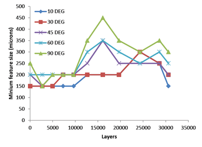

The most surprising results of this experiment is how robust the printing process is. While the finest features produced in the test print did increase in size on aggregate, the data is very noisy, and the change is slight at best. Unlike the cylinder print, no changes were made to the exposure, or other conditions used for the test print. It may be possible to preserve the printing resolution for fine features long after the window has clouded by increasing the light intensity to compensate for the uptake of the UV blocker and supply a similar dose to the print.

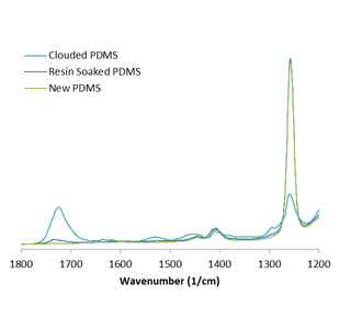

Fourier transform infrared spectroscopy (FTIR) is an analytical techniques that excels at identifying the chemical composition of a material. Attenuated total reflection (ATR)-FTIR is particularly useful variant as it only samples the first couple of microns into a sample. The FTIR spectrum of a virgin window is initially dominated by the large symmetric stretch of the methyl groups in the PDMS at 1250 1/cm. After, the resin swells into the PDMS in the unprinted parts of the window a very weak peak from the carbonyl groups in the resin is apparent at 1720 1/cm. This implies that some small amount of resin is present in the unprinted parts of the window. However, in the printed part of the window the peak from the resin is now comparable in size to the peak from PDMS. This suggests that the composition of the window at the surface now includes a substantial amount of polymer from the resin in addition to PDMS.

To get the 30 mm cylinder to print it was necessary to continually change the exposure time. Unexpectedly, it was necessary to decrease the exposure time to prevent jamming. Initially 2.0 seconds would print with out jamming, but by the end only a 1.62 s exposure would print without jamming. Why would this be necessary? One possibility is that it is easier for the print to adhere to roughened surface. Another possibility is that oxygen permeability of the surface decreases as it clouds. If the oxygen permeability is reduced, then the layer being printed would cure faster. This result may explain why the resolution did not appear to decrease as the window clouds. It may be that the reduction in light due to the the UV blocker is more than balanced by the decrease in oxygen inhibition of the polymerization.
