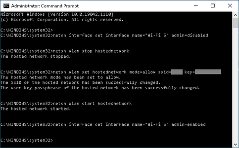

Step 4: Enable the hosted network mode. By using the following code, you will temporarily disable the adapter established as an internet client, and the hosted network mode will be assigned to the other adapter(s) to form a new network. To do this, type the following code in an elevated/admin command window (you may use WinKey+X >> Command Prompt Admin). In this case, "Wi-Fi N" should be replaced with the correct adapter that connects as internet client and should not be assigned host mode.
==================CODE=====================
netsh interface set interface name="Wi-Fi N" admin=disabled
netsh wlan stop hostednetwork
netsh wlan set hostednetwork mode=allow ssid=SetYourSsid key=SetYourKey
netsh wlan start hostednetwork
netsh interface set interface name="Wi-Fi N" admin=enabled

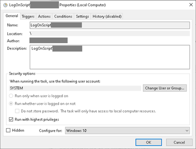

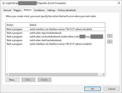

Step 5: If the hosted network mode can be enabled successfully, we can put those codes into task scheduler and have it triggered by computer log on. Task scheduler is a Windows tool and can be invoked by "taskschd.msc", and you need to create a new task for this. This task needs to use the user account "SYSTEM" and run "with the highest privilege", and you can enable the LogonTrigger or any CalendarTrigger. In the Actions tab, enter the commands one by one, where "netsh" is the program name and the rest are arguments.

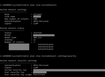

Step 7: Once internet connection sharing is set, the router should begin to work, and you can do a speed test from another device. You can also check for information and monitor connected devices using the following code on the router machine.
netsh wlan show hostednetwork
netsh wlan show hostednetwork setting=security
echo Connected clients
arp -a | findstr -i 192.168.137 | findstr /V 255 | findstr /V 192.168.137.1
