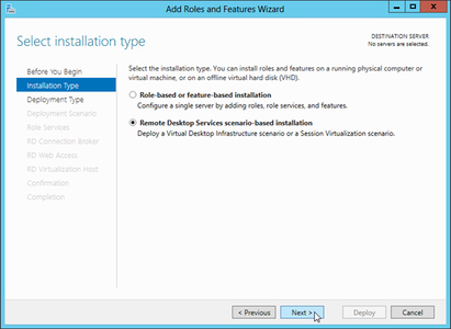

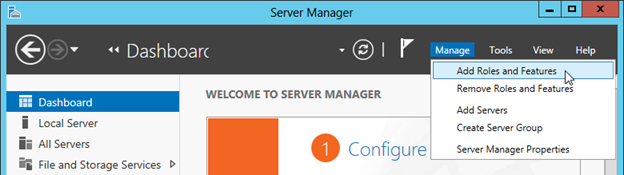

1. Click the manage menu from the new server manager. Add roles and features then.
2. Click on the "installation type". Remote Desktop service being the scenario-based installation type, click
on scenario-based information and click next.

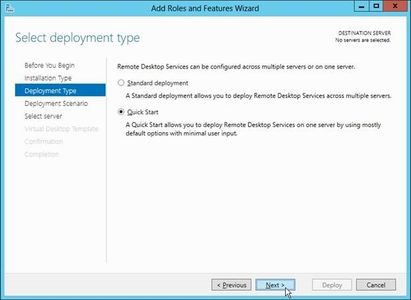

3. Click on the "Deployment type"and use the quick start deployment to put everything on one server.

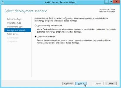

4. Click on session visualisation and click NEXT.
This allows multiple user sessions working independently on the same server.

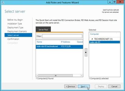

Ensure that the local server is added by default to the selected list. Also ensure,it is the same server onto which the RDS roles are to be deployed.
5. Select the server and click NEXT.

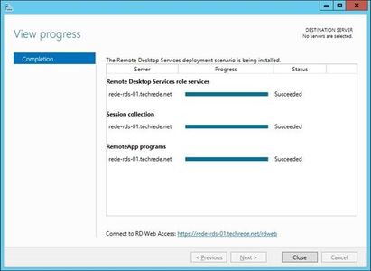

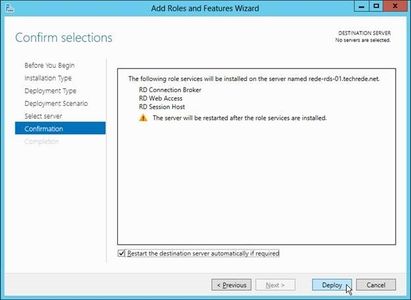

6. At the confirmation page, check the restart option as the installation of session host will require a reboot. Click on deploy option.

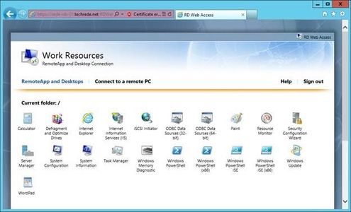

7. Get back to the server after the reboot is done to see the server manager showing the status as succeeded. Click the link at the bottom to view all available Remote apps listed.

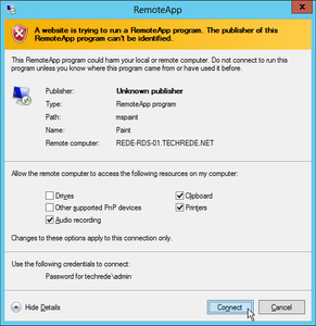

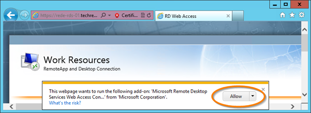

8. During connection to RDweb page, a security warning might pop up. So, click on continue for now.
Then you might be notified to run ActiveX control as this mechanism allows the remote desktop client to be launched on the website.
After getting connected, a huge list of already published applications will show up and this is because we had chosen quick start deployment.

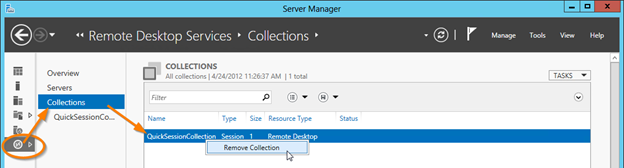

9. Return to the server manager and click on the option remote desktop services page which are present on the left. Click on collections.
There would already be a collection but we have to remove it and start from the beginning.
To remove, right-click on the quicksession collection and then click on remove collection.

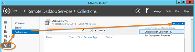

Click on create session collection in the drop down menu on the right and enter a collection name.

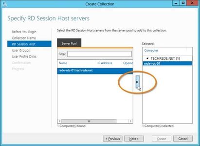

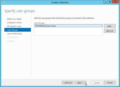

10. Then select the session host server and click the arrow which is present to add the selection to the selected list. Only one server would be available.
The default users as can be seen from the picture above are domain users. So, if any changes need to be done to be more specific, an individual application can be specified upon.
Click next.

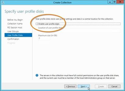

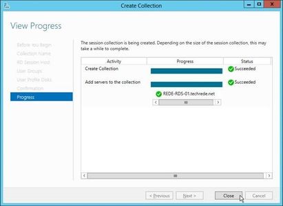

11. User profile disk is a feature that allows users to get their local data redirected to a virtual hard drive. Click next and create and finish the collection wizard.
After it is done, click on close.

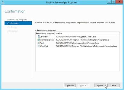

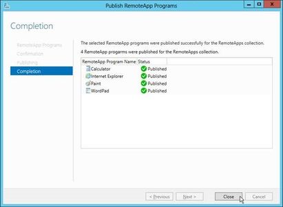

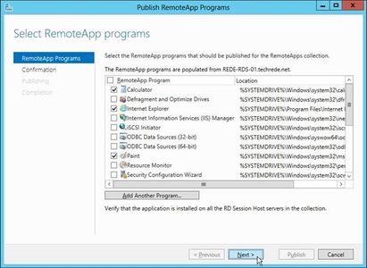

After everything is done, it is now time to publish those applications which you want to grant access for the users. For that, from the remote desktop services page, chose the RemoteApps collection that you have just made. Then select Publish Remote Programs, from the tasks button.
A program can be selected from the list or “Add another program” can be clicked on.
After the selection is done, click on publish. Close and refresh the RDWeb page and that will show up just the applications that were selected.
Click on one of the applications to connect to RemoteApp. Click on connect of any warning message crops up.

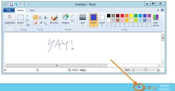

12. The application, once connected will look same as any locally installed application.
But a new system tray would appear notifying you are connected to a remote workplace.
