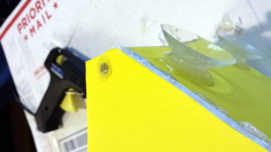

Step 4: Prepare and Attach Suction Cups
  1. If the suctions cups have metal hooks on them, remove them.
  2. Use a dime sized amount of hot glue on the back bump part of the two suction cups to bind them to the Window Mounting Board Board as shown in the photographs. These should be placed 1 inch in from the side and the top as shown in the picture. Do not get glue on any other part of the suction cup.
  3. Attach the one suction cup to the phone mounting board as shown in the photographs. Place it exactly in the center of the board as shown.
  4. After the suction cups are attached, place more hot glue around the attachment point so that the glued portion is close to about 1 inch in diameter and is completely connected between the suction cup and the foam board as shown in the photograph.

Step 6: Assemble the Foam Pieces
NOTE: The side of the foam board that was face up when the pattern was placed on the board will face outward on the device. This will help you know which side of each piece faces outward.
  1. First, attach the sides to the back piece using a thin bead of glue placed along the inside edges of the end piece as shown in the picture.
  2. Stick the end pieces down to the bead of glue.
  3. Apply another bead of glue along the inside seam as shown in the pictures to strengthen the connection.
  4. Repeat these steps to attach the other end piece.
  5. Hold the top board in place as shown in the picture. Then place a bead of glue along the underside of the top board along the window mounting board as shown in the picture to hold it in place.
  6. Hold the top board in place as shown in the last photo above. Secure this with glue, taking care not to get glue within a ¼ inch from the holes cut in the end two boards. This means that only a dot of glue should be placed between the top board and the end boards. Most of the glue should be between the top board and the window mounting board.
