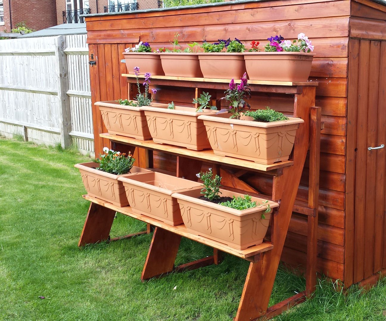

Introduction: Windsurfing Board Storage
Motivation
My wife and I recently moved into a new property lacking a garage or shed, and my initial plans of using the spare bedroom for storage of my boards and sails were not well received.
I wanted to build something like the board racking i've seen elsewhere online, like the nice examples here, with the additional need for it to be dry, secure and free standing. Aside from holding my boards and sails, I also wanted somewhere to hang my wetsuits and harness. The storage needed to be thin enough to be tucked away, but well built and tidy, and I wanted be able to ventilate it well so that wet gear does not get stale.
Dimensions
- 2.9 m long
- 1.7 m high at front
- 1.6 m high at the back
- 0.9 m depth

Step 4: Doors and Flooring and Cladding
Doors
I built this to have two doors so that I could get a through-draft on a dry day to air the contents nicely. We built the doors from scratch using cladding in a vertical orientation. The image shows the interior of one of the doors after it had been hung. Building the doors and fitting them exactly was the most difficult step. At a greater expense, but at a great time saving, you can buy pre-made doors of this type. We also added internal locks to the doors and galvanised handles to the exterior.
Flooring
Using the remaining plywood offcuts, build a floor out of three of the larger sections. The floor has plenty of strength owing to the cross piece timbers already in place. Screw the floor pieces into place. I used a small number of 30mm screws for this.
Cladding
Clad the remainder of the structure. Get hold of the correct nails for this and ensure that the cladding timbers are carefully measured before cutting. You may wish to apply an additional coat of wood stain to protect and decorate as a final step.
