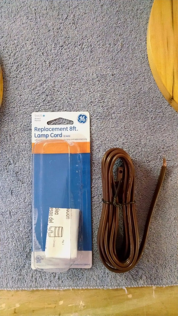

4. Replacement lamp cord

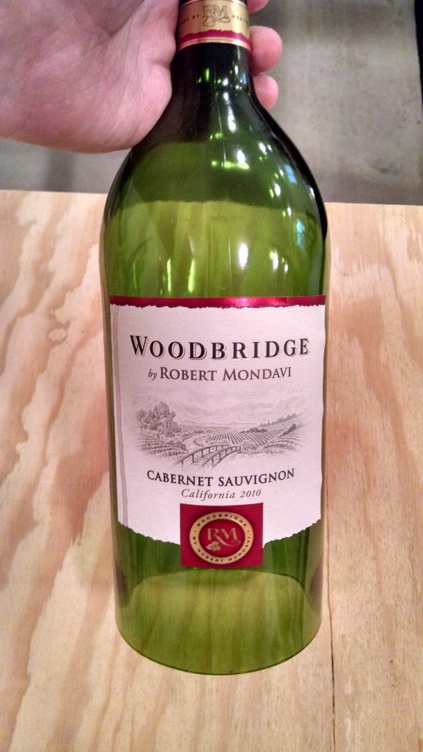

Obtain your wine bottle, remove the label, and cut the base off. I just peel the labels off and any sticky residue is removed with goo gone. Next, cut the base off of your bottle. The picture shows the bottle I used. It is one of those larger wine bottles with a diameter of about 4". For some reason I cut this bottle before removing the label, but it still worked. For info on cutting glass bottles, see my instructable.

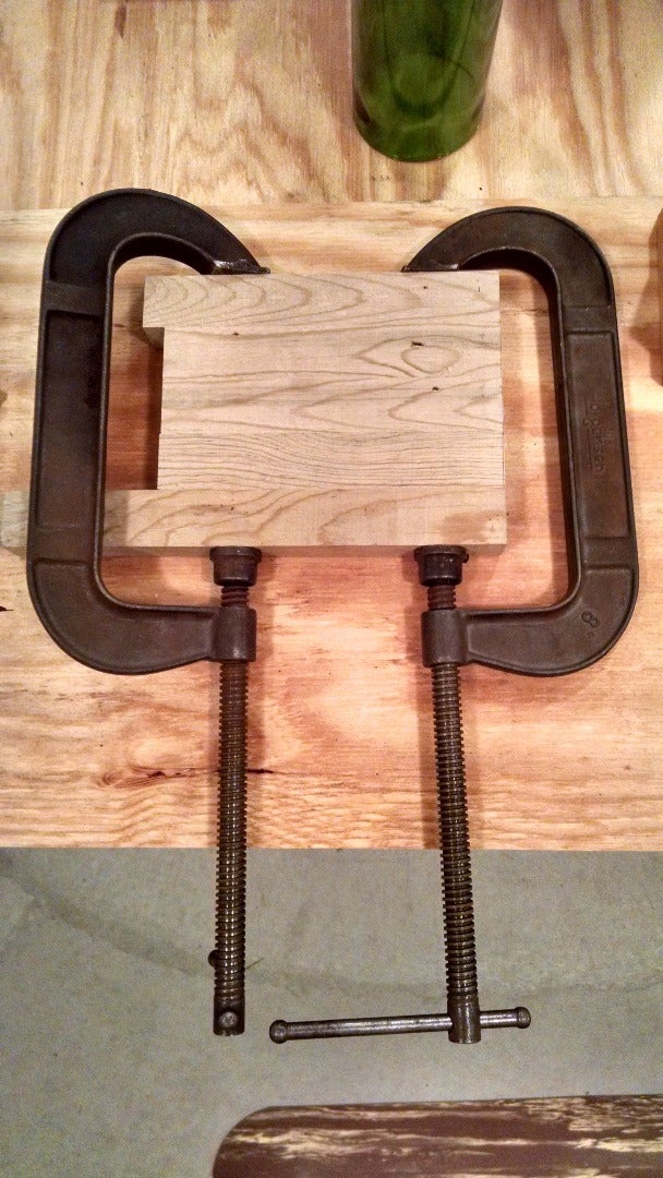

If you have to, glue and clamp together the wood you want to use as a base. My base consists of three pieces of wood. Note, this is wood I had on hand. I did not go out and purchase this wood specifically for this project. This is why the first base is thicker than the second and third pieces of wood.
I used a dremel and its accompanying circular-cutting jig to cut the circular shape of each piece of wood as well as the circular sunken area where wine bottle rests. A router was used to create the ornate outer edge on the circular pieces, the holes for the socket and switch, and the central groove the wires sit in.

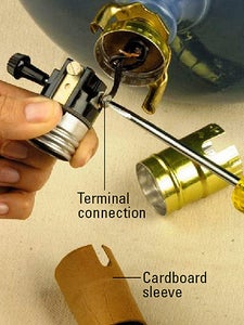

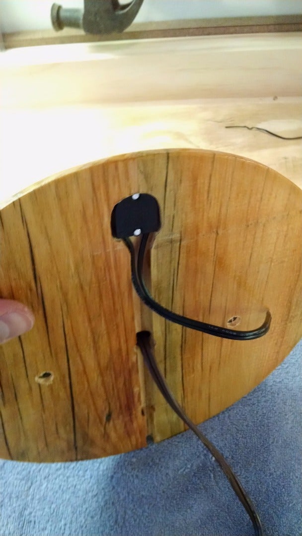

Secure the switch in place (mine was snug and required no adhesive). Thread the replacement lamp cord through the center hole and attach each side to a screw on the bulb socket. I also made an underwriters knot before attaching the two parts of the socket together. Next attach the switch to the replacement cord. I cut one side of the replacement cord and added the switch into the place where I cut. When everything is wired, lay it nicely into the routed groove and secure the wires with a hot glue gun.
Make sure to test the connections you just made before attaching the bottom of the base. Again, the previous step has a diagram showing how the three parts of the base were connected.

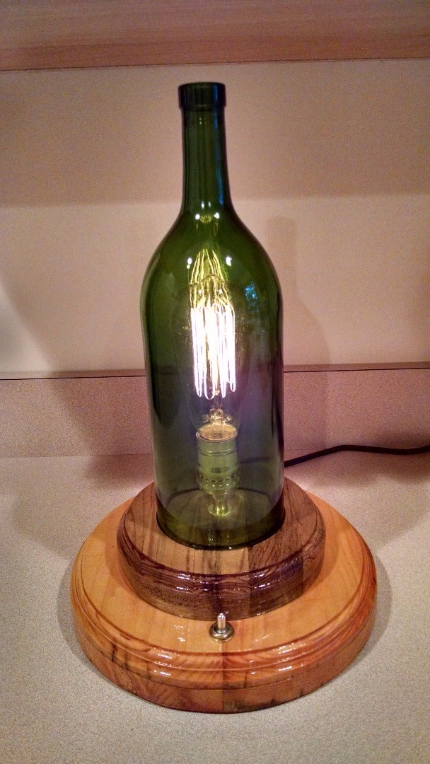

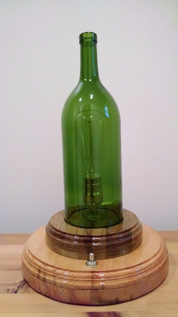

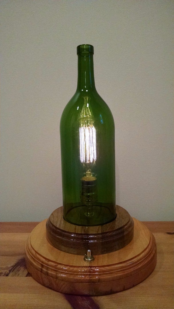

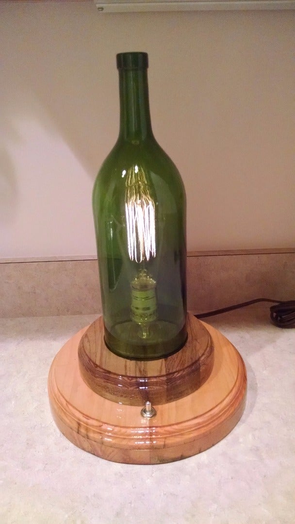

Step 7: Enjoy Your New Lamp
Once everything is wired correctly and works and the bottom of the base is attached, you can enjoy the new lamp you have made. I also added a dimmer. It is a plug-in dimmer that the lamp cord plugs into and then the dimmer plugs into the wall outlet. Thanks for viewing.
