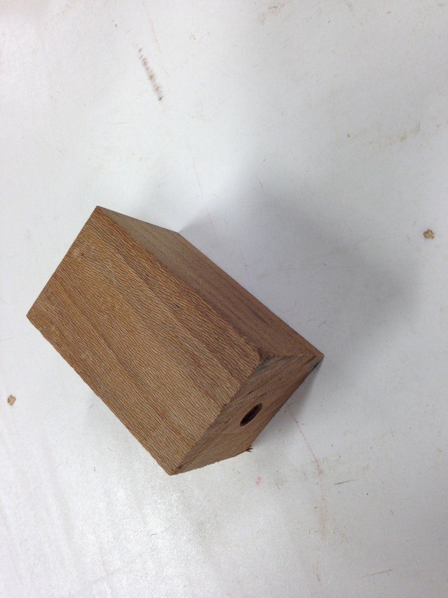

Drill a 3/8"
hole that is 1" deep into the blank at the center mark.

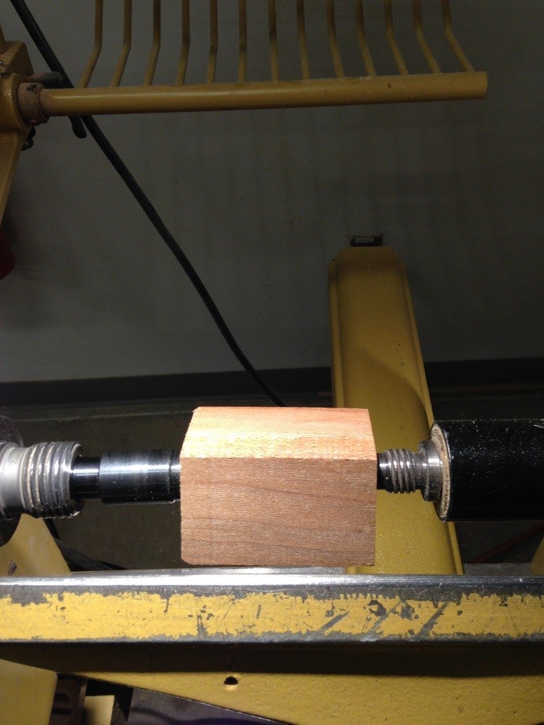

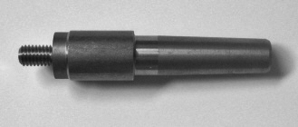

Use the bottle stopper mandrel to create threads in the drilled hole by tightening the mandrel in the stopper blank until it is flush with the bottom. Install the blank and mandrel on the lathe. Bring the tail stock up until the live center is 1/2" from the blank and lock the tail stock in place. Extend the live center until it makes very firm contact with the blank. Bring the center the banjo/tool rest on the work piece. Bring the tool rest to within 1/8" of the work piece. Position the tool rest 1/4" below center for the first operation. Spin the work piece to ensure it turns freely and does not contact anything. We are now ready to begin turning the stopper.

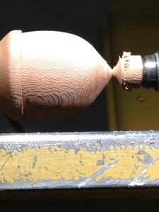

We will turn an "acorn" style for this example. This stopper features an ornamental design that makes for a great conversation piece. It has a narrow bottom to allow a firm grip when inserting and removing from bottle. Using the gouge, begin removing the wood at the base and taper the cut toward the top. This step creates a cone of wood that is slightly larger than the mandrel at the bottom. The top will extend to a point that is 2" from the edge of the mandrel. Using the parting tool, cut a deep channel beginning at the 2" mark from the mandrel. This cut can be all the way to the end of the blank from this mark.

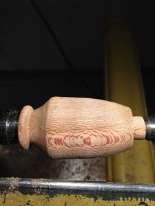

Continue shaping the stopper to your liking. Making coves and beads at appropriate points add a bit of style to the project. Once you are confident that the design is close to finished, we will remove stock until the bottom of the wood matches the top of the mandrel or is larger depending on your design. This ensures that the stopper insert will match the bottom of the stopper in diameter. If you are satisfied with final design, it is time to part of the top. Using the parting tool remove the remaining wood until only a 1/8 nib remains. Using the skew turned on edge with the long tip down, we cut a "V” groove until the nib is cut free.

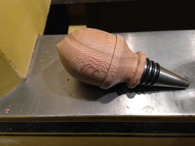

After completing the
finishing step. You are ready to assemble the stopper. Remove the stopper from
the mandrel and install the stopper insert. Viola! You have a beautiful new
bottle stopper to share and enjoy.
