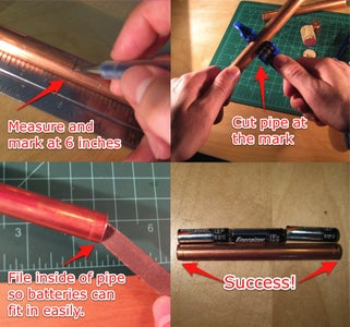

Step 3: Cutting the Pipe
Since it is not likely you have 1/2 copper pipe lying around in conveniently measured and cut 6 inch lengths you'll need to cut your 6 inch piece from a larger pipe. Most hardware stores sell copper pipe in various pre-cut lengths. For example, Home Depot sells 1/2inch copper pipes in 2 foot lengths. I suggest buying pre-cut short pipe lengths if you can, or ask someone at the hardware store to cut a longer pipe down for you. This way you don't risk causing a car accident as you drive home with 10 feet of copper pipe hanging out the front of the passenger side car window. Just a suggestion...
On to the cutting... copper is a real soft metal so it's really easy to cut with your standard screw type pipe cutter (show in the picture).
To cut the pipe:
- Measure from one end of the pipe 6 inches in length and make a mark
- Place the pipe cutter blade at the mark and slowly turn the pipe with one hand as you tighten the screw handle with the other. This will slowly pinch down on the pipe and cut through it in a few turns.
- Use a metal file to clean the inner edge of the pipe. You want make sure that the AA batteries needed to power the light can pass through the pipe with out getting stuck. It may take a bit work to clean up the edge.
- Check to see if the pipe is the same size as 3 AA batteries. If it is then you're done. Nice work!
Note: You might also try using a hack saw instead of the pipe cutter if you have one. Just don't apply too much pressure as you cut because you might squish the copper pipe. I recommend the standard pipe cuter over the hack saw as it leaves a cleaner edge on the pipe and is slightly safer to use.
