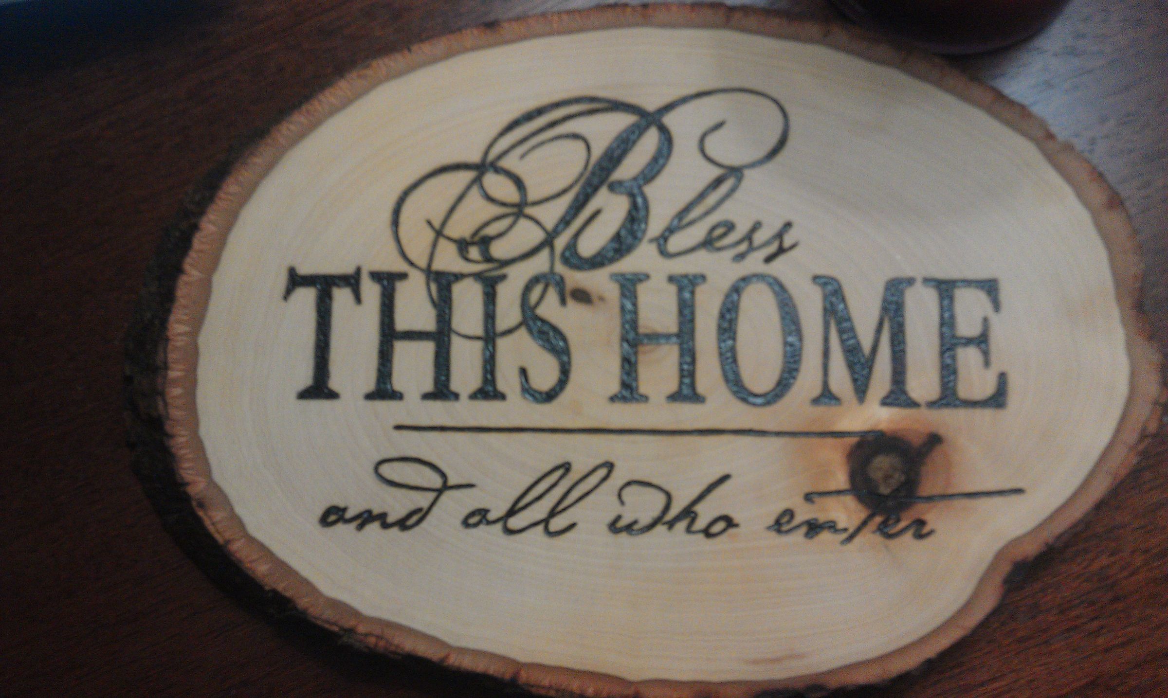

I generally burn an initial into each piece. Wood burning will be the next instructable!!
