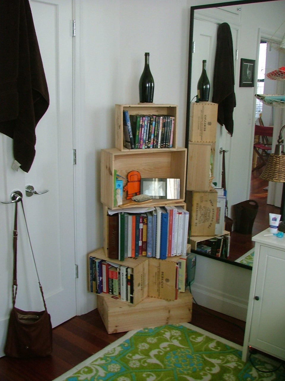

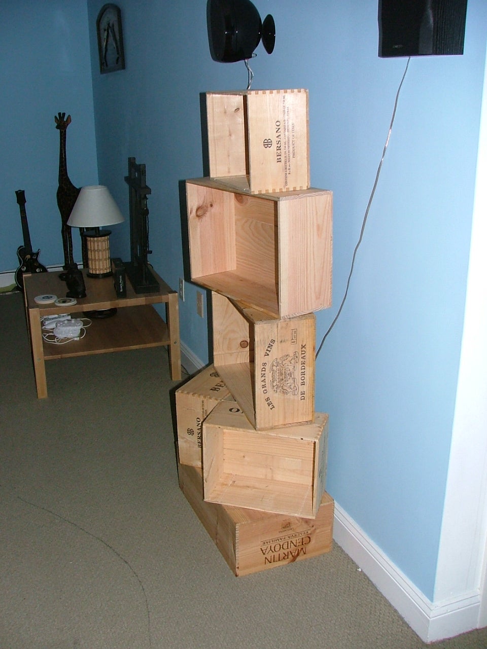

Step 3: Arrange Crates...
I chose to arrange the crates at staggered angles to create the appearance of a randomly stacked pile of crates. Its important to use one crate upside down for stability and to clamp and test your arrangement for lateral stability. Keep in mind how the weight of the contents of the shelves will affect the stability of your design.
Check out my other projects at Reclaimagination

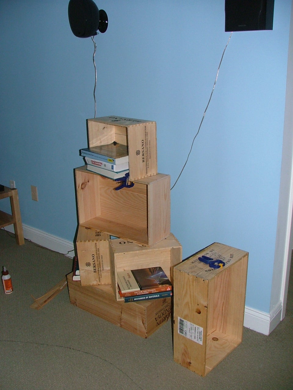

Step 4: Glue Crates...
I used Elmer's Wood Glue to glue the crates together. Most wine crates are made of rough pine, so they will really suck up the glue. All you need are two thin and even layers on the two surfaces to be glued together. I used textbooks and quikclamps to keep the crates together while the glue cured. I let each application cure for 24 hours. All told, it took 3 days to glue my shelves together.
Step 5: Fill the Shelves...
Depending on the orientation you used, you may need to use small angle braces to stabilize the shelves. You may also want to stain and seal the pine but because the surface is rough, you will need to do a lot of sanding. If you were to sand, I suggest doing that in Step 2.
Because I was able to get the crates for free, the total cost of this project was only the cost of the glue.
Enjoy!
